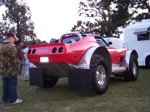

When I saw this thread, I thought you mean't "lifted" c-3s
Sorry, couldn't resist.

Articshark, I didn't see that coming.
