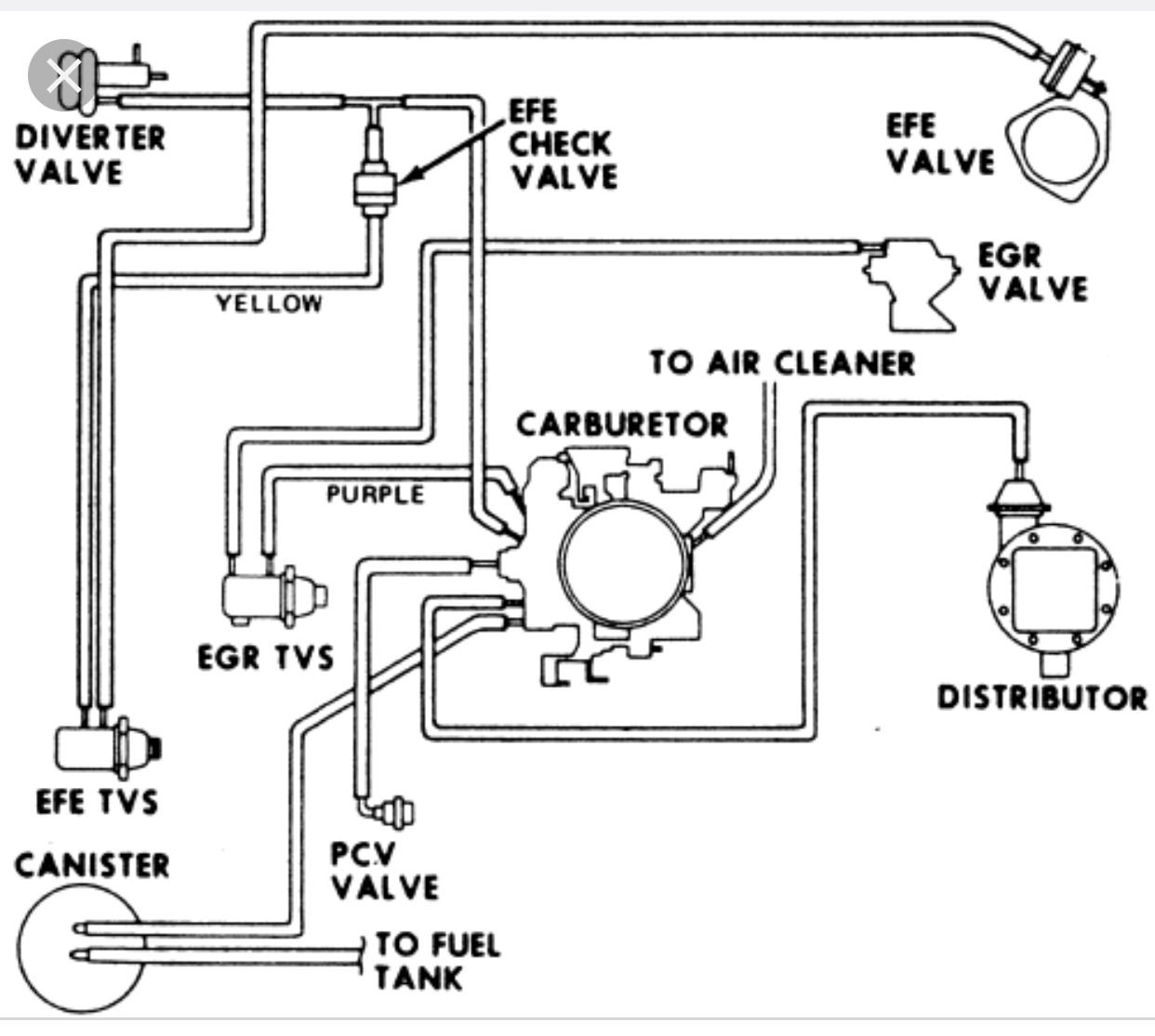

So don't want to bring back up the topic as to whether one should remove the egr valve or not rather my question is how much of the system (including EFE) can be removed once the decision has been made to go with a non-egr intake (i.e. edelbrock 2101)? I understand you can just plug the tube from the egr tvs but can that be removed and just plug the spot on the Qjet?? There is alot of tubing that I would like to remove and I am just curious as to how much of the system can be taken out. That is, where do I put the final plugs?
