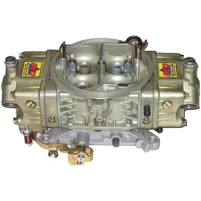

Well I ordered an AED 750 HO Double Pumper. AED is actually right across town from me and is a great shop, and make the carbs and all their other AED branded parts in house. I got it from Summit though as they actually sell the carb cheaper than AED sells it in their own showroom.

The carb pictured has 4 corner idle.
They are a little tougher to dial in.
Once you get the carb dial in you will be impressed with the performance.
Be prepared to buy various jet sizes and boosters to get it really dialed in.
Better yet, find someone that has a bunch of Holley tuning parts you can borrow and figure out what works best for your engine.
Back in the day, I was lucky enough to have access to a automotive machine shop that had every imaginable Holley part. After a few hours I knew exactly what I needed.

A local shop does dyno tuning by the hour + cost of the tuning parts they use. I'm thinking of going that route. I've always set up my own carbs, and was happy with getting them 90% perfect. I've got enough time and money in this car now I'm willing to pay a couple hundred bucks to get that last 10% with a dyno slip to prove it .
