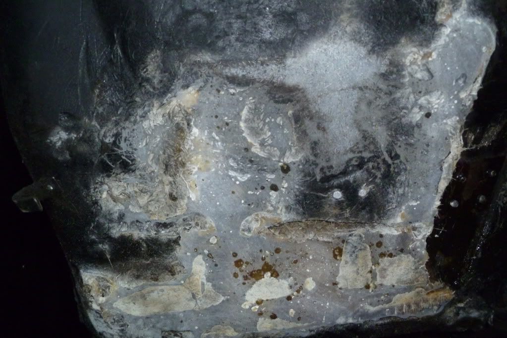

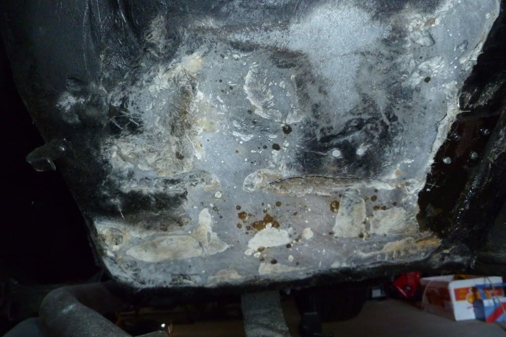

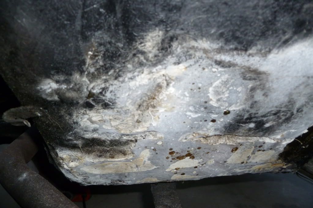

Now that I have the engine out its time to have a look at a repair that looks like our old mate Bubba has done.It appears that Bubba has carried out a repair using cardboard and fibreglass.
Ive been putting off this repair because I have no idea what I'm going to find.
So today I started to remove the cardboard and start sanding back all the excess glass thats there, I have a few photos that I have taken. Open to any advice you may have.

it doesn't look too bad. possibly a small(if there is such a thing) fire. how does the inside look? if the inside looks ok, just remove the metal brackets, sand and clean the area. taper the edges of the deep voids, and build these areas up with small stips of glass and epoxy resin. i like the woven cloth because it will conform to the irregular shapes better than mat glass. when the deep voids are level with the surrounding areas, add two or three layers over the entire foot-well. then redrill the bracket holes from the inside(you'll be able to easily see the original holes), and pop-rivet the brackets back in place. if the inside needs help, just repeat. check for cracks near the headlight dimmer switch and where the gas pedal attaches. it'll be (ayers) rock solid.

Since you have to grind anyhow, I'd grind as much of the old repair out as I could and make sure it is fixed properly. Mine was cracked across the bottom edge and the PO repaired it with duct tape... I ground both sides back 3" or so from the crack with a right angle die grinder and 2" disc and cleaned it real good with acetone. Let the acetone flash off overnight and then started filling with layers of increasing width cloth. I only mixed a couple ounces at a time and had all my cloth pieces pre-cut to finish one layer. Did the same on the other side feathering out to the edge of the fresh fiberglass. Probably 8 overlapping layers total, at least as strong as original. Cutting a small paint brush to get short, stiff bristles helped saturate the cloth by stabbing instead of brushing. It's a messy job on the firewall side, wear old clothes and rubber gloves.

Thanks for the quick replies, I think i will continue to grind back the old glass as their seems to be a lot of big air bubbles, and in those areas it hasen't stuck very well.

Just an update pulled the carpet, and from the crack down the original footwell is gone! The light shines straight thru and you can see where the repair meets the original material. I'll now just fill the holes as best i can to make it look level and as true as possible.

i believe that if the exterior is strengthened with a few layers of glass, you'll be ok. worst comes to worst, build up the exterior, then remove as much of the old interior patch as possible and add glass as needed. i had to repair similar damage in my 70, and it's solid now. i made a matrix with cardboard covered in plastic drop cloth material to act as a form because a large area just fell away as i was preparing for the repair.

Your 68 is a polyester resin car. Use polyester resin to repair it, not epoxy.

i disagree. epoxy is stronger and will bond to any material.

No right hand drive conversion, I think its either accident, though I'm not sure what you would hit that would leave the floor intact and undamaged, or possibly side pipes as it looks like at some stage in its life they have been fitted.

I think I'll leave most of the old repair their as it solid, and tidy up the rest so that it is neat and looks right.
