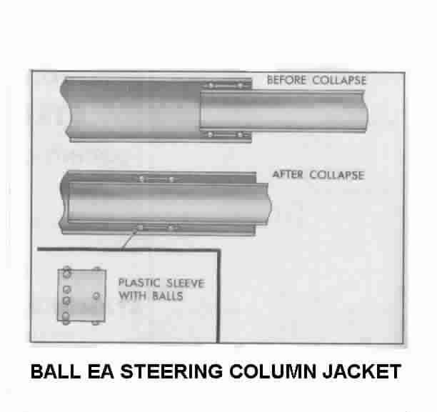

BTW, the telescoping tubes in the previous posting is actually the energy absorbing joint that is used in the steering column jacket. It was invented, manufactured, and placed in production at Saginaw Steering Gear starting in the 1969 model year.
