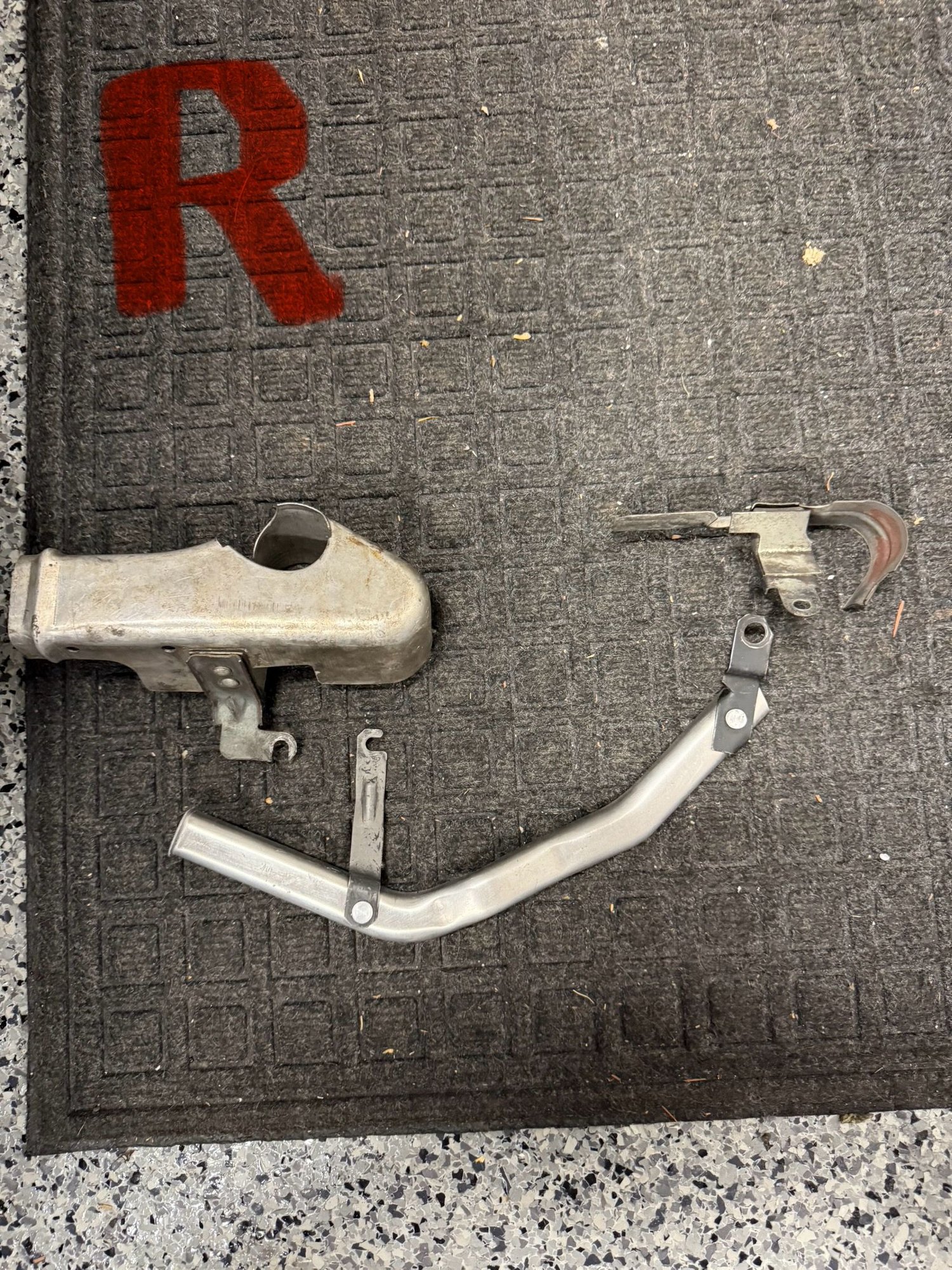

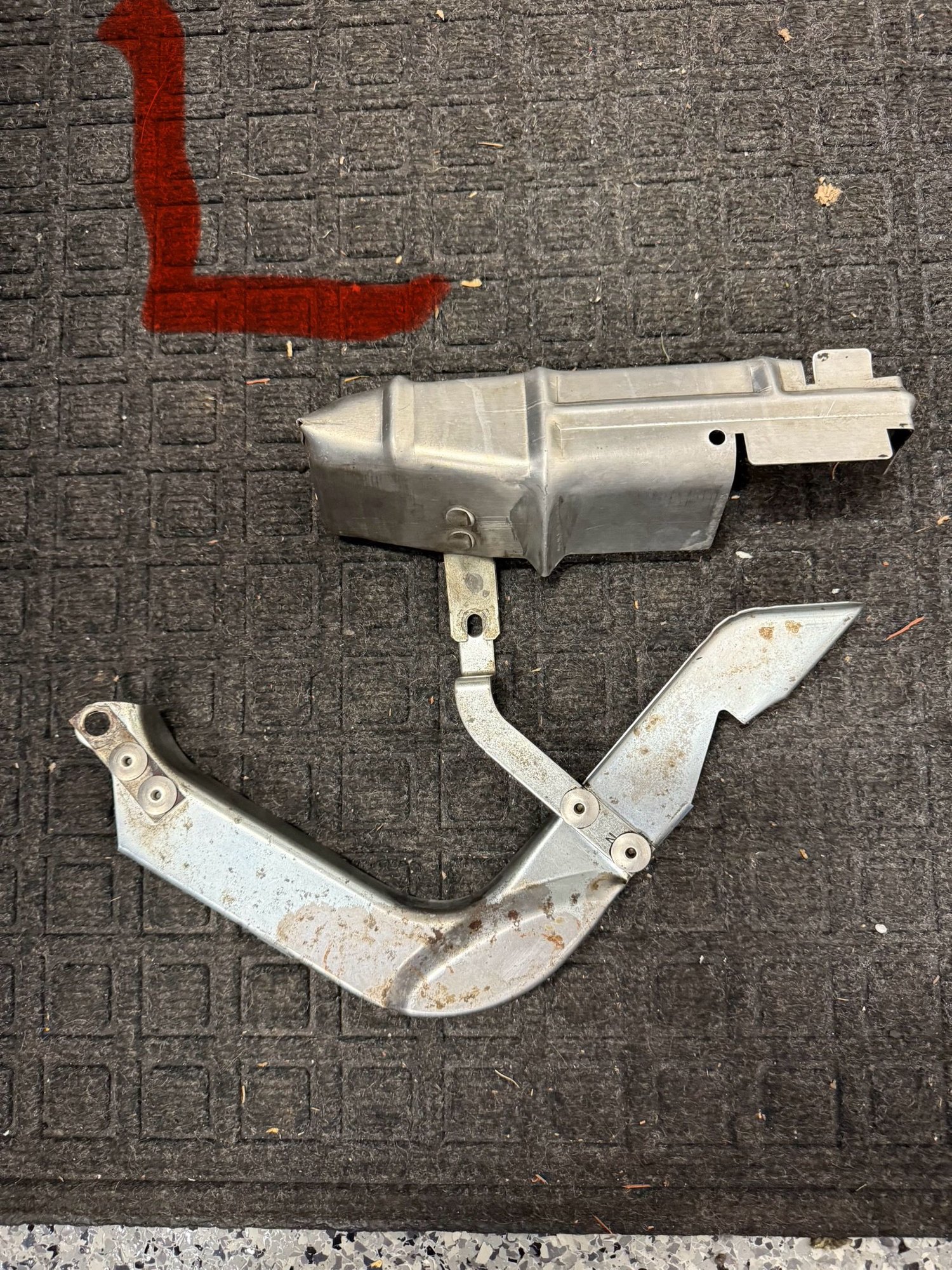

Found this old post and thought I would add some pictures of the ignition shielding.
Left, drivers side.
Left, drivers side.
Right, passenger side.

Seriously? In the last 14 years I'm certain there have been many pic's of ign. shielding.
Old Jul 21, 2025 | 04:54 AM
LS6 Motor's Avatar
LS6 Motor
Joined: Apr 2005
Posts: 1,283
Likes: 12
From: New York
Of an 82, I don’t see any reason for the sarcasm, seriously…
