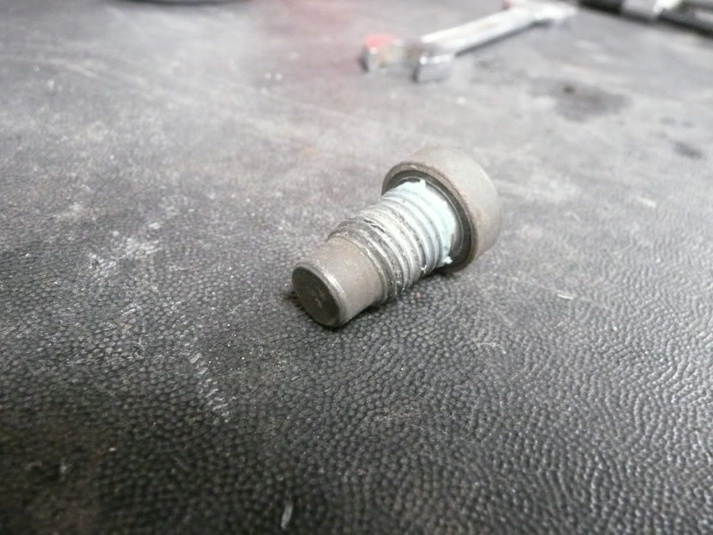

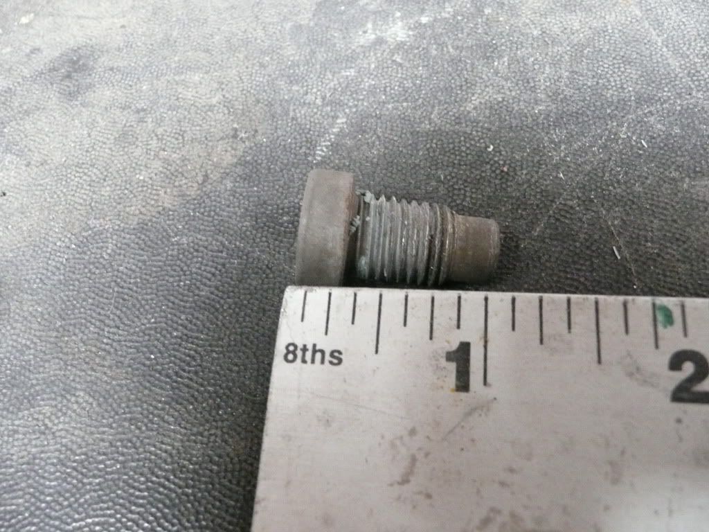

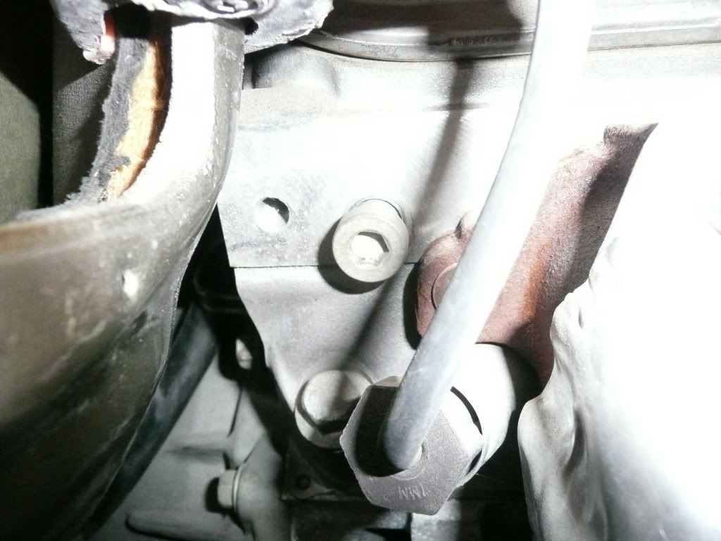

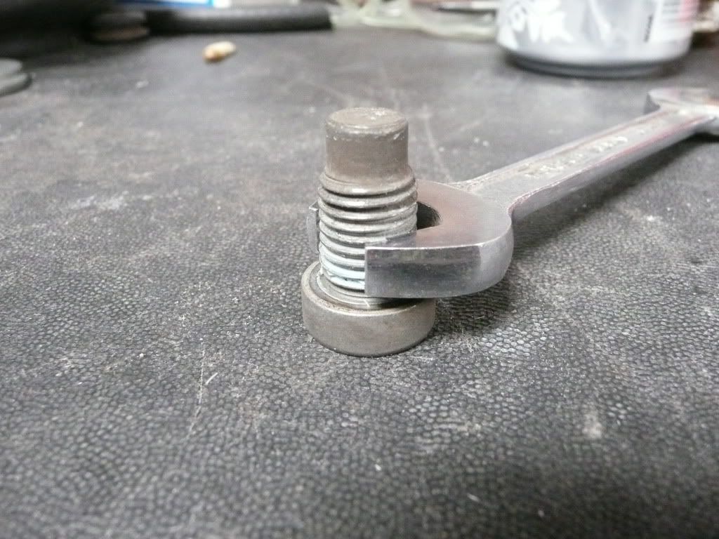

I need a single wire temp sending unit for a LS1. It needs to be 85 to 135 ohm I believe. It has a 12mm size thread. I have included a picture with a 12 mm wrench. The picture is of the plug in the place where the sending unit will go. I need two of them does anyone have one. This is in my Newman chasis 1961 with a LS1 motor, but I would think anyone putting a LS1 in a C3 would have the same issue.
