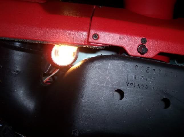

Passenger side mounts to a bracket that is installed in the kick panel.
On the driver's side there is no mount or hole to fix one of these 90* metal tab like brackets nor do I have one.
The housing looks just like the one for the passenger side. How is the driver's side courtesy light affixed and to what?

It doesn't mount like the pass side, it snaps into a molded in recess under the dash.......

Can someone post a picture of where the passenger side mounts?

Jeez.....That was fast! Thanks!

Darn...that's kind of where I was thinking it mounted.
I went and checked my dad's 1980 and I must of bumped it out but it looked like something in that area was holding it. Standing on my head I could see there was something molded in there but I can't get it to snap in place!

It's a pain to get em snapped in, probably why so many aren't!

Thanks for the pic. I let my drivers side courtesy light dangle for nearly three years (come oct this year) I will put it in place tomorrow.

I can’t view the photos posted about how the drivers side courtesy light mounts on a 1980 model. How do I view them?

None of my pics are showing up on the site.
Must be something to do with Flickr, have to look into it.
Posted the above pics direct from my files.

Thanks so much, KapSa. Able to see those pics. Helped me get it done. Much appreciated.
