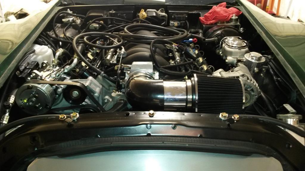

This is a bit off subject but how well does an LS 3 fit under stock 79 hood?
Old Dec 2, 2014 | 11:40 AM
79Guy's Avatar
79Guy
Joined: May 2010
Posts: 15
Just fine. Air filter comes really close but clears.
