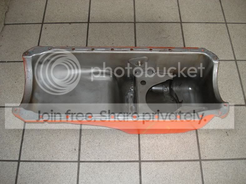

i use this oem oil pan with the related windage tray ( it has a front flap door)
which is the difference in respect to the LS7 oil pan you say ?or just the same at the end?
my question is : i added 1qt more oil for track days to avoid possible oil priming loss. May i add even more oil ? 427 crank
which the problems with too much oil? just power loss or other? i prefer to save the engine and loose some hp

That look pretty close. Looks like they may have added a flat shield at the front now days. Been a long time since I held one in my hands.
http://sdparts.com/details/gm-perfor...parts/14091356
Too much oil can cause as much issue as too little. If it gets in contact with the crank it will start to *pull* it out of the pan and wrap around crank and also foam the oil real bad. Aerated oil is bad. Again...drainback is the key. Big blocks dump oil on top of the cam/crank which doesn't help much.
It's one of those things you just need to test for how you drive. Keep an eye on oil pressure and see if it drops from aeration at high RPM. At that point you can either try .5 qt more or .5 qt less and see what it does. Every car is different with respect to how many G's it can pull and on what course you're on with RPM at whatever speed.
I'd still use the biggest filter I could get (2 qt) and use that to add some overall capacity and make sure filtration didn't cut things. I also wouldn't run the mega restrictive type filters. Use something a little more open if you're running hard.
