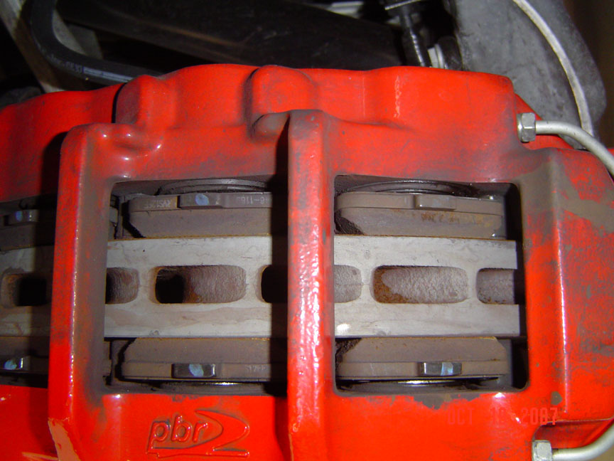

If you chamfer the leading and trailing edges of the pads at a 45° angle you will eliminate most if not all brake squeak! Even the factory does it now. Here is a photo of my ZO6 brake padlets (4 of 6 in the front caliper). I have done the same to my '69 pads with good results.
No need for any goop this way.
Pete
