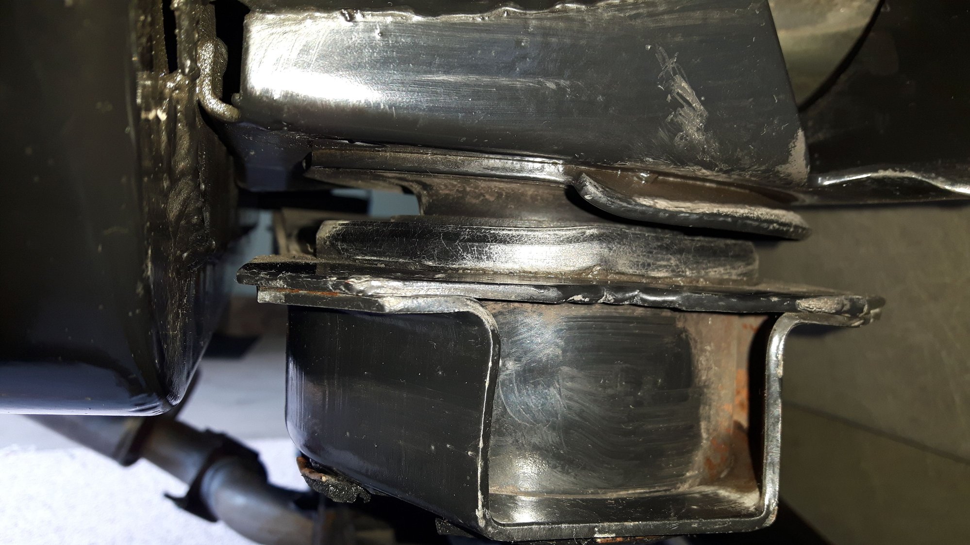

[QUOTE=68/70Vette;1578274862]I went out an looked at my original 1970 frame and it's differential crossmember bushing. I looks like there's about 3/8 inch clearance between the bushing cushion and the frame. I was surprised. I thought the bushing would be flush with the frame Is this the bushing to frame gap your talking about? '65 coupe. From what i have been reading in the threads here this is normal? I looked at this and thought i had a problem.

other side

Yes I searched out this old thread and was compairing it to my car. But I was not sure if the gap in my pictures was actually that area referred to in this thread and that it was normal. It's my first Corvette and I'm still learning.
