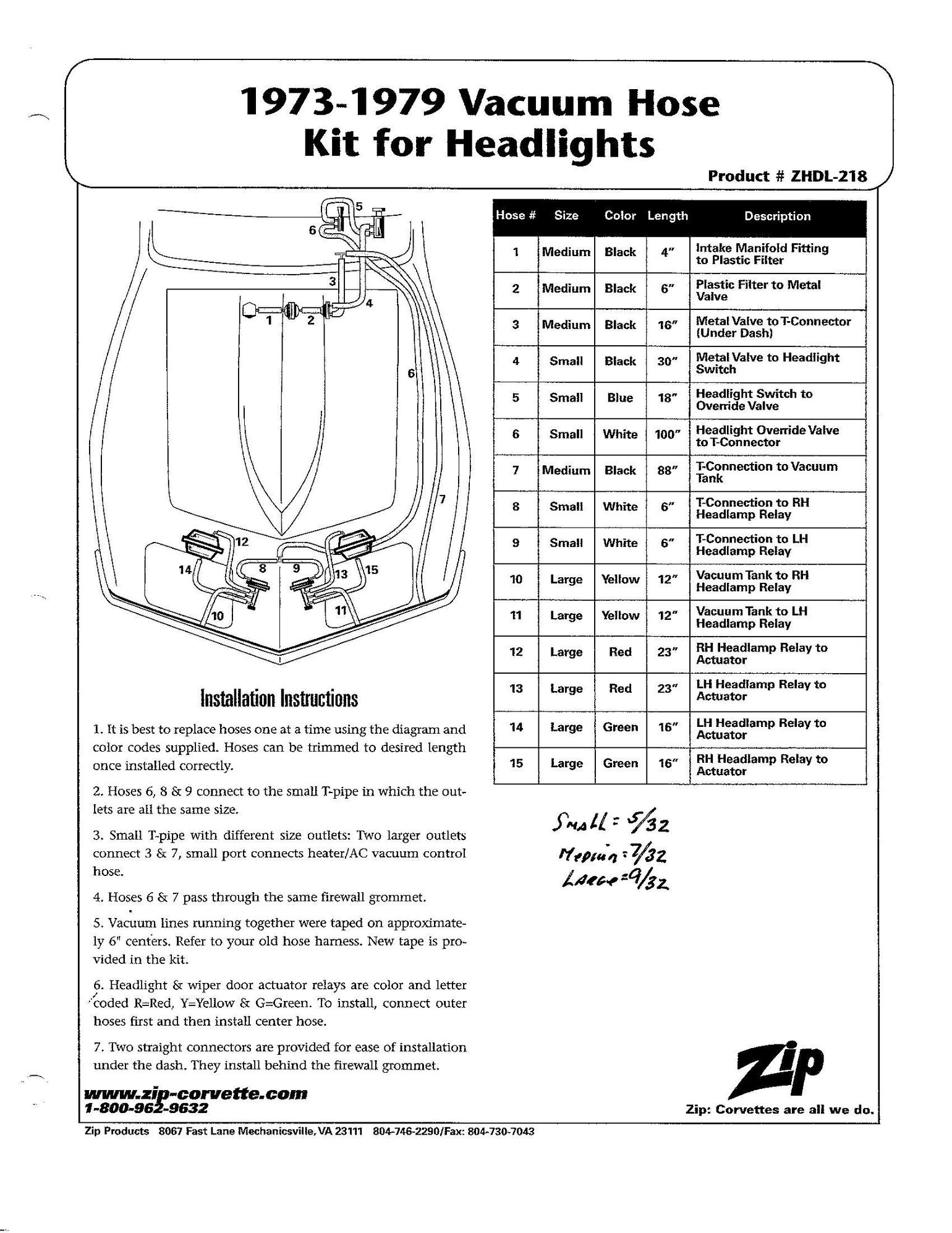

I have a 75 and cannot find any vacuum hose diagram. I took my dash apart and now cannot find any diagram that references my 75 even Willcox cover all years except for the 75 that identify which color hose belong to which actuator. Please help if you have any info to share. Thanks.
Old Jun 1, 2020 | 10:01 AM
Peterbuilt's Avatar
Peterbuilt
Joined: Aug 2006
Posts: 7,427
Likes: 1,560
From: mount holly NC
Default Hi and welcome!
Does this help?

Dear Friend,
I am grateful for your reply and the courtesy you extended me by attaching a diagram. The diagram is a simple yet very descriptive of how to put back the vacuum hoses under the hood/ I am sure it is going to be very helpful once I start working on my headlights. I have taken the entire front dash from inside my car. I am trying to reassemble all the various hoses that are used in putting my AC and heater back in working order. If I am not mistaking there are 4 or 5 actuators inside my car and a bunch of vacuum hoses each with different stripe colors. The actuators are controlling the temperature and the direction of the air blowing in from the A/C or the heater. Most of the hoses being from the temperature control dial and get connected to different actuators that control the airflow. This is the information that I need and where I am stocked. If there exists one I need a chart/Diagram that is displaying how various color hosses should be connected to each nipple of the temperature dial and the destination in which each hose should be connected to.
This is my first time joining a forum and did not have any high expectations of receiving any assistance. I was very pleasantly surprised for the help I received and again, I am grateful for it. I am looking forward to hearing from you.

Hi Again,
Here's the information that you asked for:
The drawing is from the assembly manual (AIM), you should order one.
Back to the headlights, this may help:
Vacuum Troubleshooting
