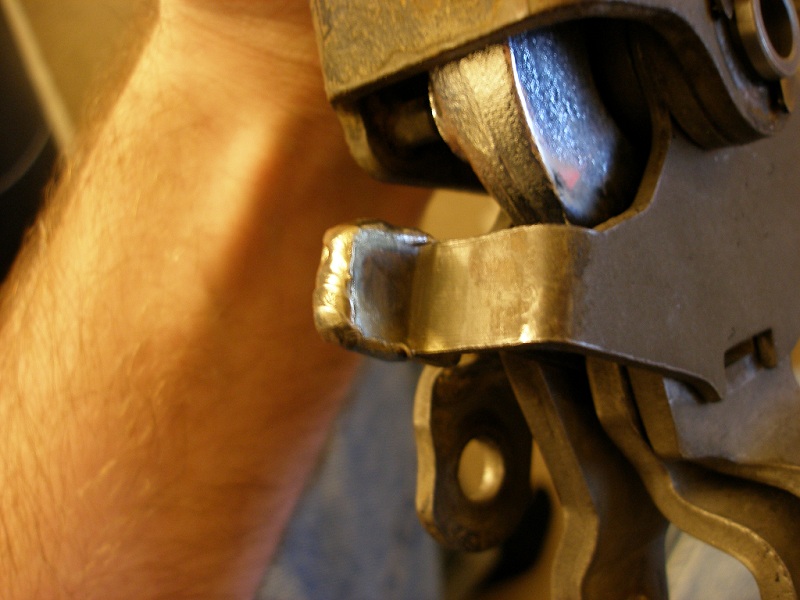

I had a similar problem with my M20. It turned out the shifter housing spread a little, it allowed the shift lever to go in between the gates after it was stuck in gear. I welded the housing, then rebuilt it using a rebuild kit from Volunteer Vette. Shifts beautifully with no slop now.
http://www.volvette.com/SH005N.html

Here is a picture of the spot I had to weld to keep the shifter body from spreading again.
