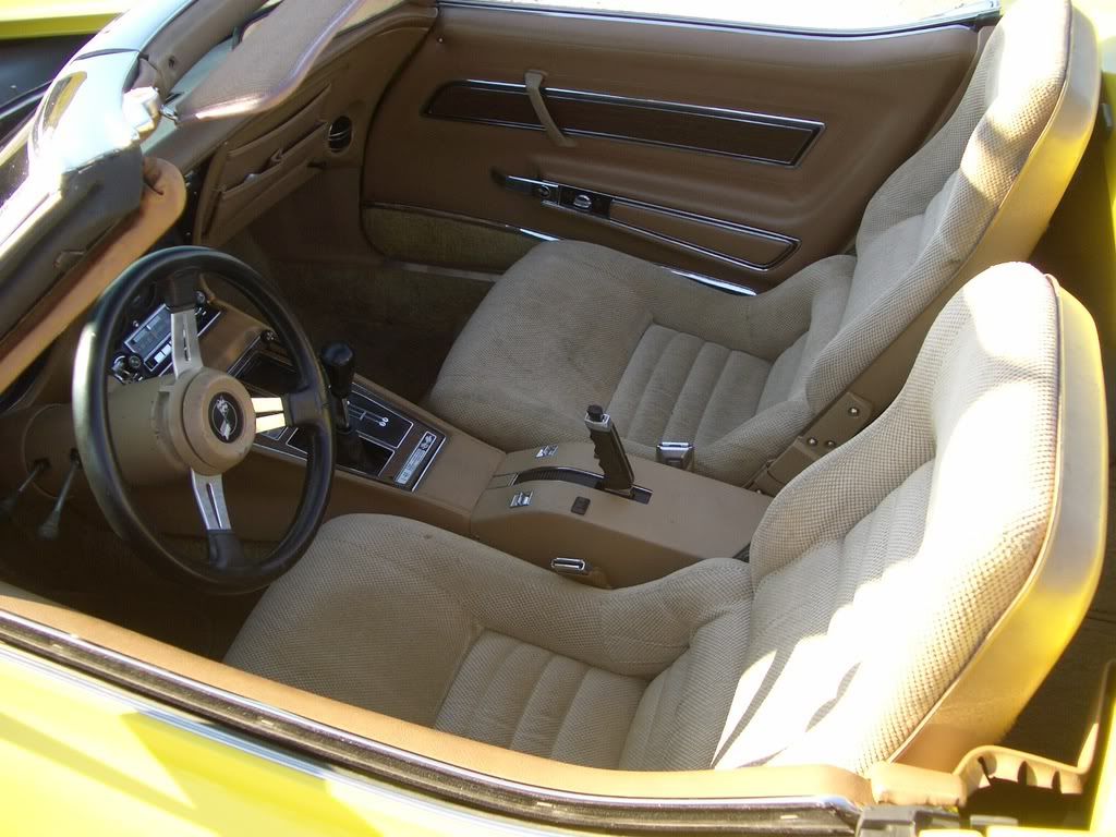

I not even sure that the adapter will work on the tilt/tele column. The Grant catalog says that the adpater is for 1968-1982 Corvette All Models (without telescopic).
Grant does make a wheel that bolts directly to the tilt/tele column.
791 - Black Leather
792 - Mahogany rim
794 - Mahogany rim with black spokes
I have the 791 on my car and it is about 1" smaller than the stock wheel. Easy install, just replaces the stock wheel.
Not the best pic but you can see the steering wheel.
