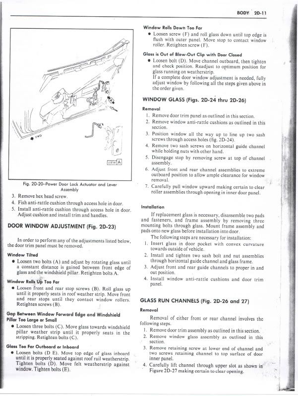

Print these they have a tendency of disappearing...
Location of adjustment points.
[IMG][/IMG]
Follow these instruction in the exact order...
[IMG][/IMG]

Thank you very much the instructions i have say to adjust window until equal distance of the front and rear pillars. i will try again tonight they are proving to be a real PITA. Thanks again
