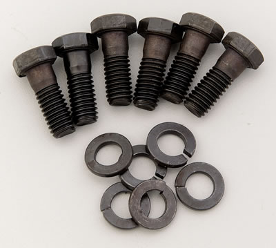

Is the gold colored grade 8 bolts that you get at like Lowes or Tractor Supply a good enough quality for attaching clutch to flywheel?

No Sir.
Pressure plate bolts have a specific shoulder on them to locate things properly and recess down into flywheel slightly.
You can usually get some Mr gasket ones if nothing else in a blister pack at many parts stores.
Don't take chances with your feet.

No. I stand corrected, I forgot about the shoulder.

No, the correct bolts are not completely threaded along the shank.
Like Jim said, don't risk your toes just to save 8 bucks. Mr Gasket p/n is 910.
