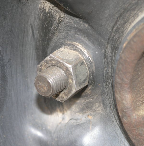

These are aftermarkets.
not wheel vintiques (which I used before no issues)
Opinions on this?
How do originals look/fit the nut in comparison?
These never seem to be real tight when Im taking them off.....they are when I put them on.
I hope.....these arent unsafe junk wheel guy denies ever selling them to me today. Course I pay cash and dont write off anything so I didnt save the reciept. 1 was so out of round I had to toss it (chasing vib. issues)
Not one of the other 3 were perfect...but just balanceable.
Ugh.
I dont have it sitting perfectly straight but you get the idea.
Will these be ok or ?

If it were mine , I'd use steel lug nuts, that one you have pictured appears to a later year used on stock aluminum rims. your rim shouldn't be marking it up that way.I've had wheels come of and pass me going down the road

Those were what he gave me with the wheels.
Where can I get stock type? Same place carry them youd think or?
was just worried that countersink wasnt large enough.
Are the stockers different from these? Its been a long time.
Shoulda known better than to fall for a "great deal" but at the time I needed wheels and was
down on coin. Cant expect much for $45 ea. Made in China of course.
Like to use them for awhile if I can though til money for some better ones..or draglites falls into my lap

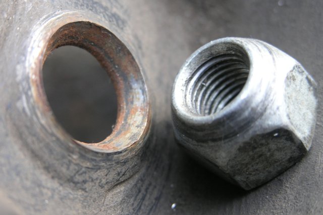

Slalom if you get a minute a pic of the mount flange would be great.
Yes those nuts appear different
Thought the originals had a little larger countersink area with more meat around them. Just want to be safe...
Was concerned with that little area contacting the wheel and them digging into the nut they are loosening up on me.
Really wanted some GM 15x8s...but these days they are so pricy.
Even used

Just got back from NAPA $30 later have a set
These are shorter not that it matters like the pic....but did notice these threads go to the very end of the nut whereas the ones from the tire guys didnt. Dont know if that makes any difference. Have a feeling there are sharp edges on the wheel cutting into the nuts.
What a pair of garbage rims suppose they will get me by for a while.
See how it goes.

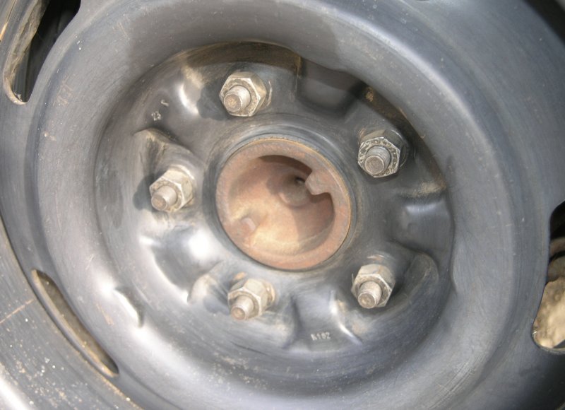

A couple of OEM C3 15" x 8" wheels from a neglected ride. I have
7 or 8 of these wheels, all but two of which were purchased new.

Perfect just what I needed and thank you!!
These nuts sit farther down in the countersink like yours do...like they should.
that tiny wear bit on my first pics were all that was clamping the wheel down. Scary.
Id laugh if thats where all my mysterious driveline vibration was coming from. Find out tomorrow when I mount them up.
Half tempted to inquire about those 8s...have a line on some 6s for fronts too....just no extra $ right this second. DD ate it again this week

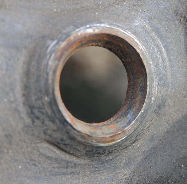

From: Edmonton AB
This
Looks like this Dorman 611-014
Courtesy Summit Racing
If that's what you have, then these have the appropriate 7/16-20
thread pitch and 60º conical seat. Perhaps there are wheels that
have a larger diameter seat?
Could you measure and post about the respective diameters of the cones.

I'd laugh if thats where all my mysterious driveline vibration
was coming from.
How close a fit does the hub bore of the wheel have to the shoulder/flange
on the hub?
The OEM wheels shown above have a snug fit.

Slalom couldnt get back on teh forum last night for some reason
The ID of the hole is .5, where the conical part starts one is .6 (believe thats the "wrong" nut, new one .7. hard to tell as the worn one could be giving me a false reading. In any event the new ones fit much better as in your pic

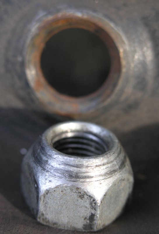

Way back in Post #2 oldalaskaman identified the proper application
for the lugs nuts you originally got from the vendor.
For wheels like these below, factory lug nuts had stainless caps for
appearances, but my vote is that they are functionally the same
as what you received. The larger cone provides more load bearing
surface for aluminum wheels.

These are steel so Ill use the stock type they fit as yours do in the pic much better.
Wheel guy says steel wheels cant use the rings, no where to put them. Aluminum only. The lugs center these nicely on the stud.
Judging from the lugs in pic 1 being wrong and how they got chewed so quick Im damn lucky I didnt lose a wheel or break a stud. Sticky tires + 580hp not good.
