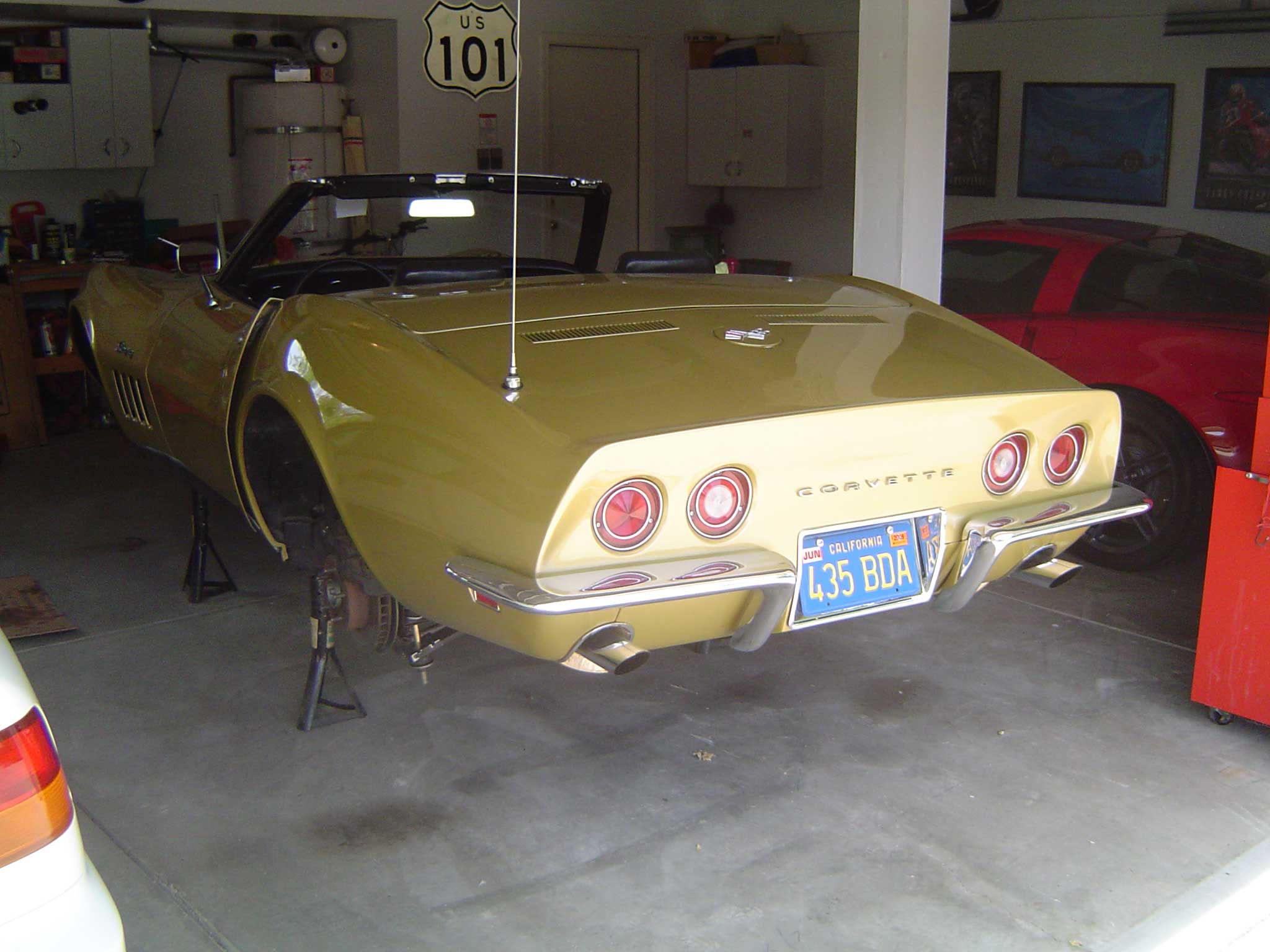

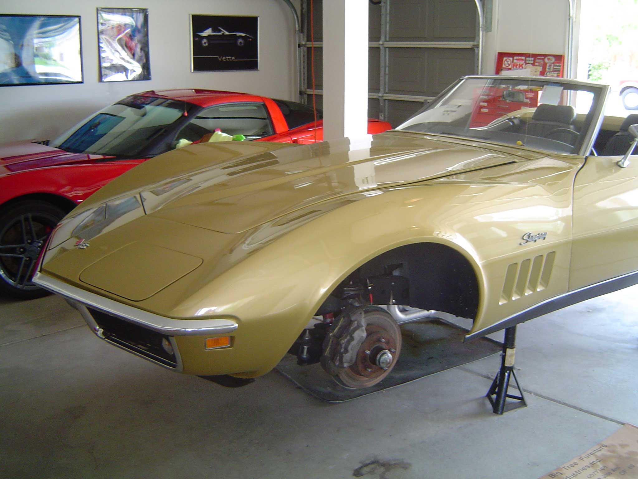

You'll get all kinds of suggestions on jacking.
Foremost, have a good floor jack! DON'T depend on the jack that is in the Vette. And make sure you're jacking against the frame, not something sheetmetal under the car!
When going up at all 4 corners I like to jack from the side with the jack at the end of the trans crossmember where it connects to the frame. But not TOO far out where it could slip out and damage the rockers!
I like to place jack stands at the flat area in the rear just forward of the wheel well where the frame changes direction and if i'm not working on front suspension I go under the lower control arm right under the shock mount.
Shop books recommend front jack stand location as under the frame just before the frame slopes up, basically at the front of the door. I avoid this if possible cause it leaves a lot of weight hanging out in front. Some guys will add jack stands under the frame near the radiator.
Personally, I feel the shop manual recommendation is somewhat a liability thing. They don't want you crawling under the car to place stands!
Many people jack the front under the front crossmember under the engine. That's why so many C3s have dented frames there
And like you noticed, altho the best location on most other rear wheel drive cars, there's just too much stuff in the way to jack under the differential.

I took KapsSA's advice and jacked from the side.
I have a Sears 3-ton floor jack that reaches just about 20''.
I placed the jack about 2 inches in front of the trans crossmember, took out both t-tops and opened the windows.
It creaked and groaned just a little and then went straight up. The jack just fit under the frame, so I had the full 20 inches to lift, more than enough to lift the tires and get the additional 6 or so inches that the car ramps required.
This procedure worked great - highly recommended.
