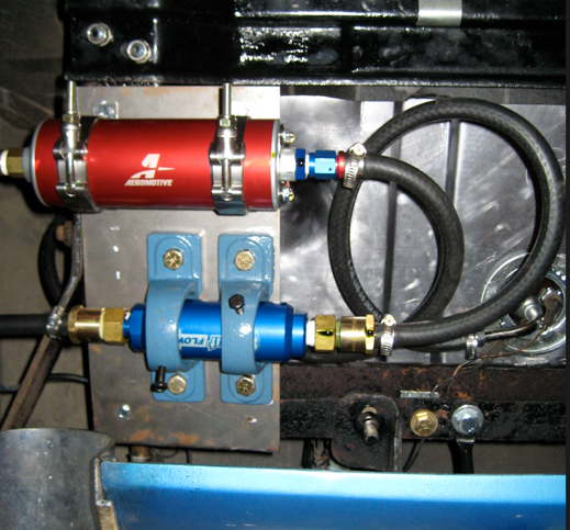

I went with an SS internal fuel pump/sump kit from Rock Valley, for noise level and because of the design that traps fuel around the pickup. The pump stays cool because it is submerged in the fuel. It cost $375 including the Walbro 255 LPH pump, and is very well made. It is made to fit into the stock tank. If my tank wasn't basically brand new, I would have went with the complete Rock Valley SS tank and fuel pump/sump. I had my local race shop weld it in my tank for me, then I custom bent SS hardlines for it. I then painted the tank.
Here is my tank installed in the car:
No problems with this set up after a almost 3yrs of use. The pickup has never gone dry under any situation, and I have ran it almost completely empty a few times; once less than 1 gallon in the tank!
