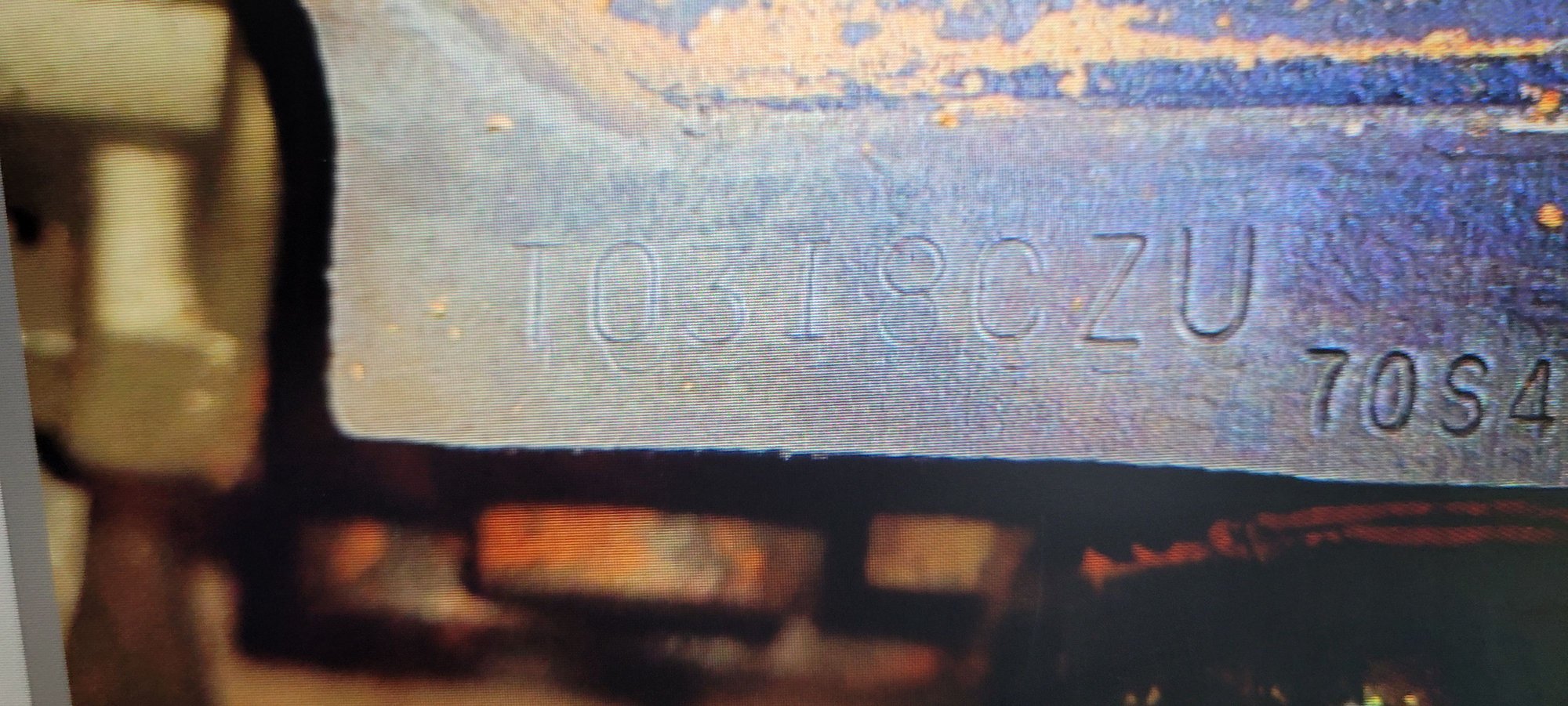

I have a 70 corvette with a BB 454 with matching numbers, engine and body. The block casting number is 3963512 with a stamp of T03I8CZU. The head casting number is 3964290. I am having to replace the engine and trying to order a long block from ATK/Vege-Gearhead. However, they tell me they do not have my numbers in their data base, so not sure which of their engines to order. Is this a common problem? Has anyone else had this problem when replacing an engine?

Now I am worried about your builder..... The 70 Corvette only had one BBC engine option available, a 390HP 454 called the LS5.
The CZU block stamping is correct for a 4 speed version. a CGW stamp for an auto version and a CRI stamp for a 4 speed version with Transistor Ignition. That is why there are 3 stamp codes.
Only took me a 3 second Google search to find that. Your block casting number sounds correct also.
