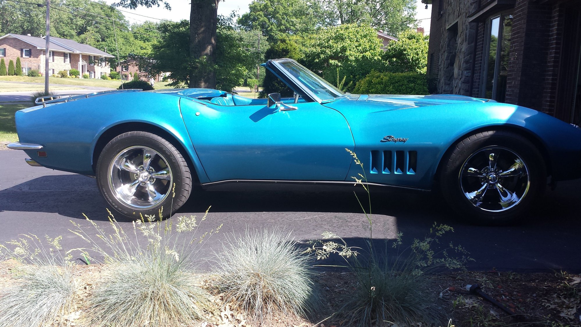

I thought I would close out this old thread. After much procrastination I finally pulled the trigger on a set of 17" Coy C5 wheels.
While waiting on the wheels to arrive I tried the following:
  • had driveshaft balanced. no change in vibration
  • replace driveshaft u-joints as one of them felt a little rough. no change in vibration
  • adjusted driveline angle. Went from transmission down 4 degrees/diff down 1 degree to transaction down 3 degrees/diff at 0 degrees. No noticeable change in vibration
  • Replaced all tie-rod ends as the drivers side had some play. Slight improvement in vibration
  • Borgeson conversion - I knew this wouldn't affect the vibration I was having, but the original steering box had a tremendous amount of slop in it and needed to be fixed.
I'm happy to report that 90% of the vibration has been eliminated with the new wheels. There is still a slight vibration between 45 and 60, but not enough to ruin the driving experience.
gratuitous photo of new wheels
