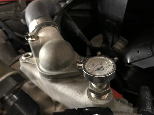

Go to Pearl Harbor Freight and get a cheap Infrared Thermometer.....get the car hot and shoot it at the thermostat housing.....compare this with your gauge and make a mental note......
My gauge in my 72' is way off......so I bought this liquid filled mechanical gauge for under the hood......an idea for you. It is fairly accurate....right in line with my Infrared.

Originally Posted by jb78L-82
good suggestion..like that idea. Did you put it in the thermo sending unit that was OEM on the intake? Thanks
Nah....the sending unit is in the head....
This is a Team G intake.....
I have an oil pressure gauge under the hood too....I am crazy like that....
