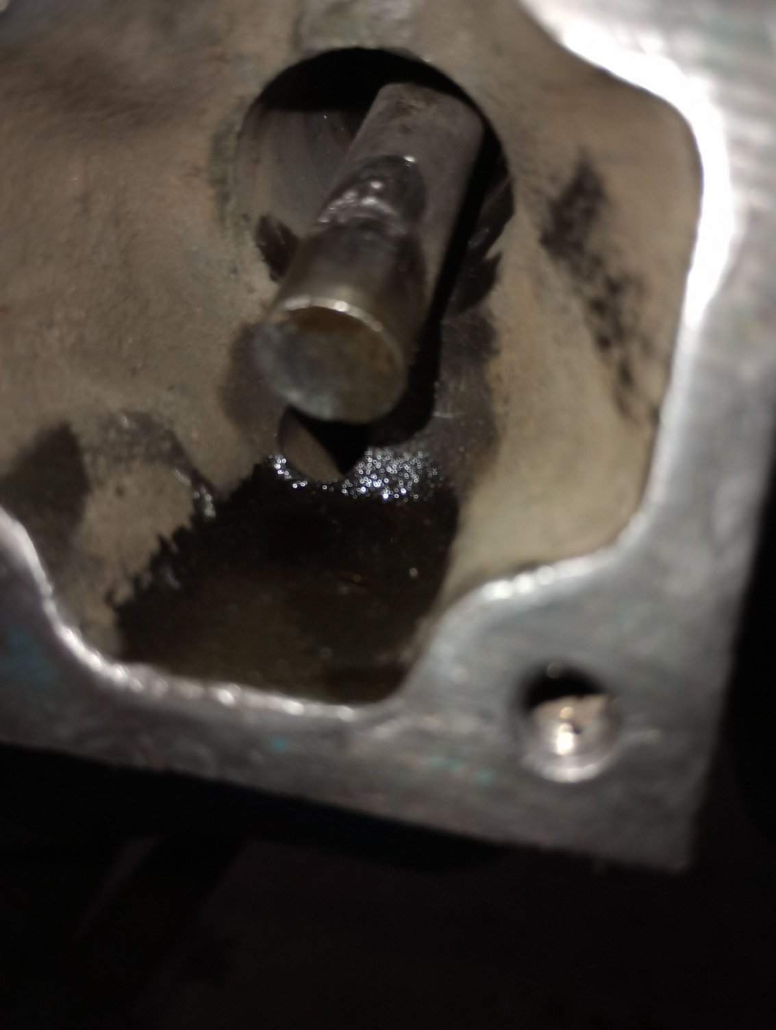

Got this 1979 vet had electric fuel pump,it went out, took off blocking plate where the manual fuel pump goes and found the pushrod still in there.i have tried pulling it out but it does not move. Ive clamped needle nose vice grips on it with no luck heres a pic
The gouge was already in there
I couldn't get a welder in there so i blocked it back off and noticed that the return line was not hooked up.how would i get that push rod out.besides tearing down engine and is it going to hurt anything like it is is doesnt move and there is no sounds when engine running. running

To answer your question, No it won't hurt anything.
That pushrod probably has a brass tip that mushroomed and is now trapped in there.

Yes you should start a new thread however check the front of the block and make sure someone did not put a too long bolt thru the threaded hole that will hold the pushrod in place for changing the fuel pump on a small block. it could be that or like stated above the push rod has a mushroomed bronze tip. welcome to the forum.
