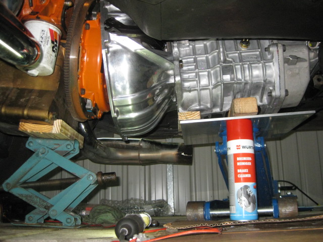

http://forums.corvetteforum.com/c3-t...1-munci-4.html
Btw:
the TKO600 wont handle a "big big blown" race car unless you are talking of a Honda
The big advantage of the TKO-Kit is, that it fits in the tunnel without major changes or cutouts.
Hurst wrote in the manual, that it can be used for track racing, but they don´t recomend it.
If you think really big...I don´t know...try a T56.
