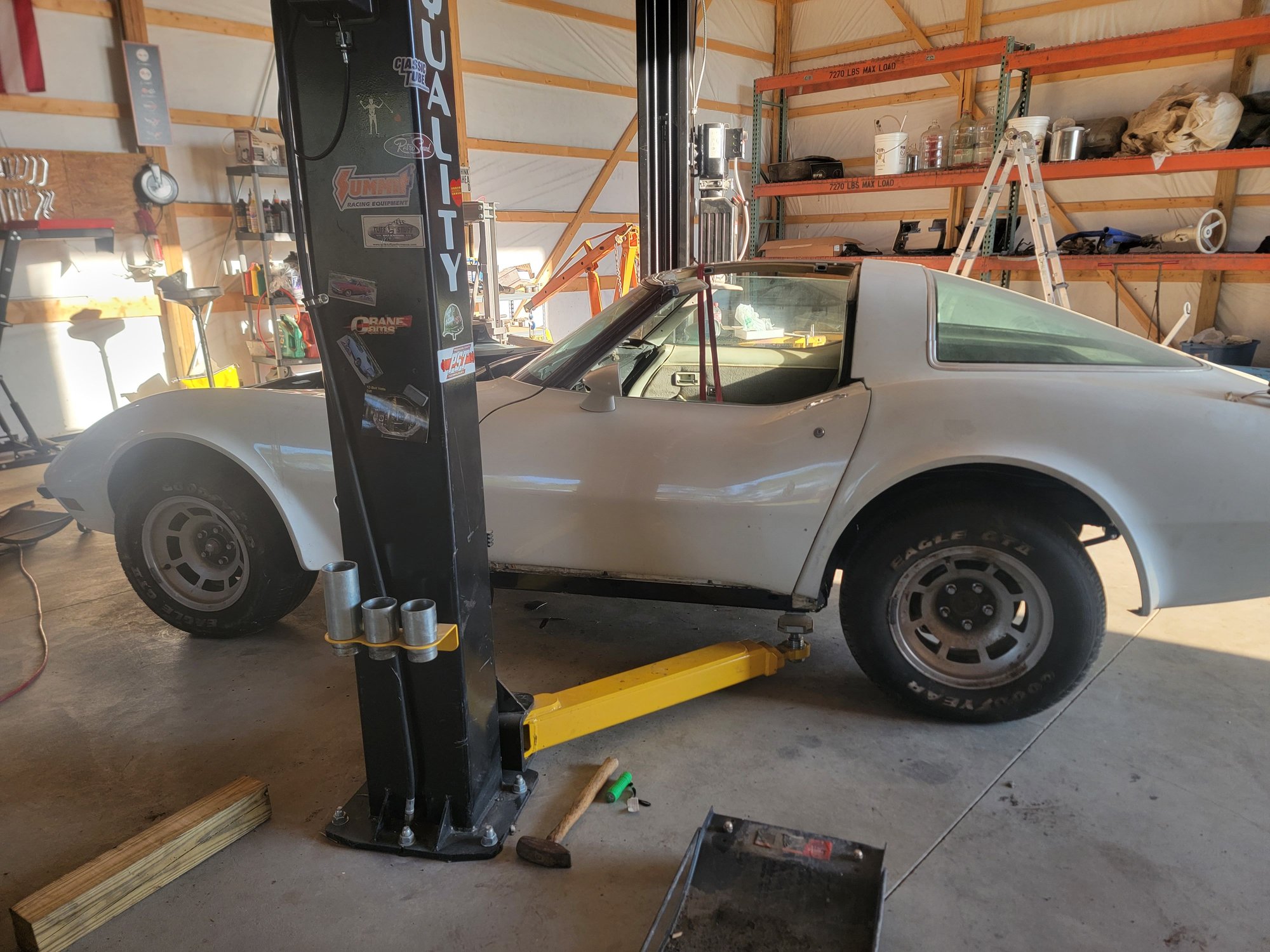

Three frame-offs at once!
And I thought I was ambitious with one! LOL

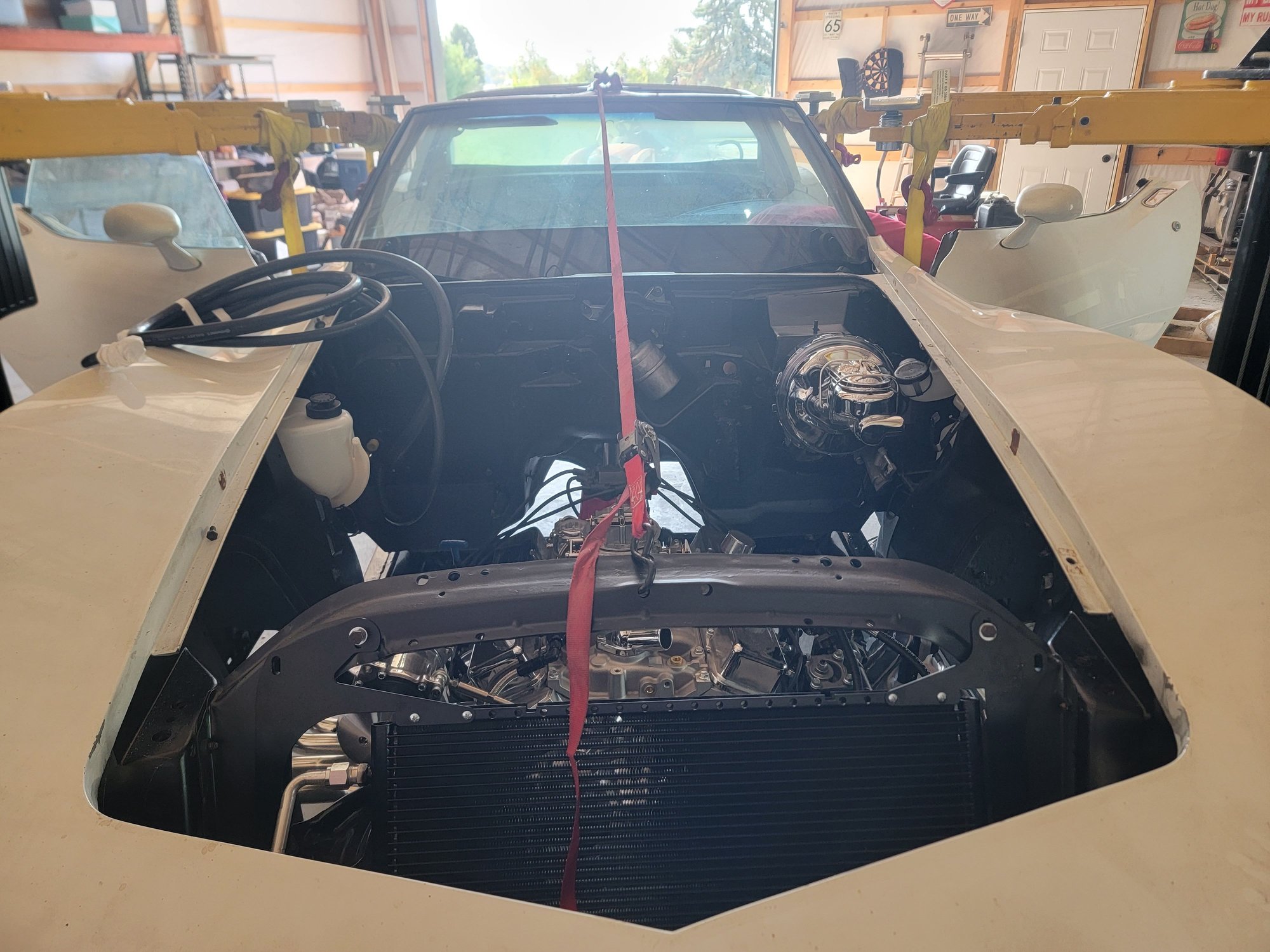

Wow! That's quite the set up Bob! Yeah, a strap or two gives me good piece of mind. I noticed it sliding around a little on the rack so why not. Better safe than sorry especially considering how often times there is beer involved when I am working in my barn.

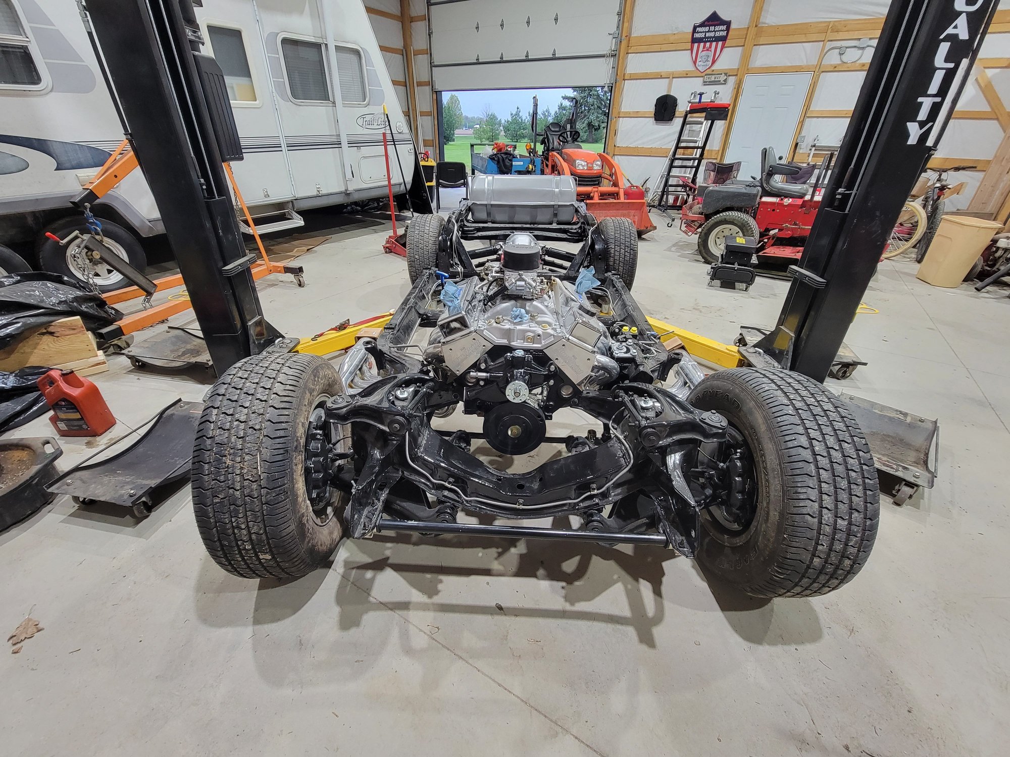

Making some good headway on my build. Brakes are rebuilt, I decided to stick with the lip seals right or wrong. I got the runout on all of my rotors to .003 or less. I've got my blue print 383 home and a Trimic TKX mated up to it. I must say I'm very impressed with silver sport transmission and their installation instructions and the fitment of everything thus far. I'll take a little break from my build now to work on a few other projects, but the next thing on my list is to start rebuilding the differential.

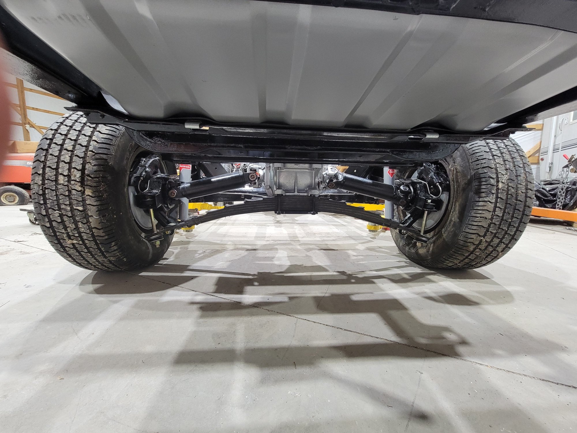

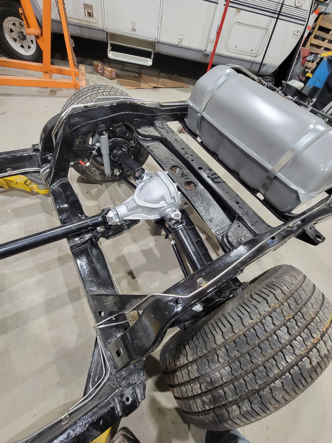

Time for a little update. First of all big thanks to Gary Ramadei for all of his advise on rebuilding my differential! It was a lengthy and time consuming process but I'm very pleased with the outcome. I certainly learned a lot taking that job on myself.
Last night I got the rear suspension mounted and half shafts installed. As I was setting the chassis down on the ground, it occurred to me that this is the first time in ten years that my car has sat on tires, completely on its own running gear and with a complete drive line! It's a good feeling!

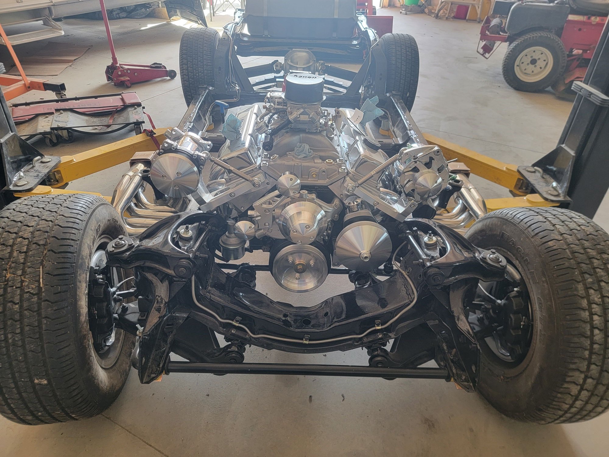

It's been a while since I updated, which is ok since this for me to journal my progress as much as anything else.
I have my March serpentine system installed and it looks amazing. I went with their outward mount system. They say it will fit so let's hope!
I've got my fuel system put together
Even test ran the engine and man did it sound amazing!

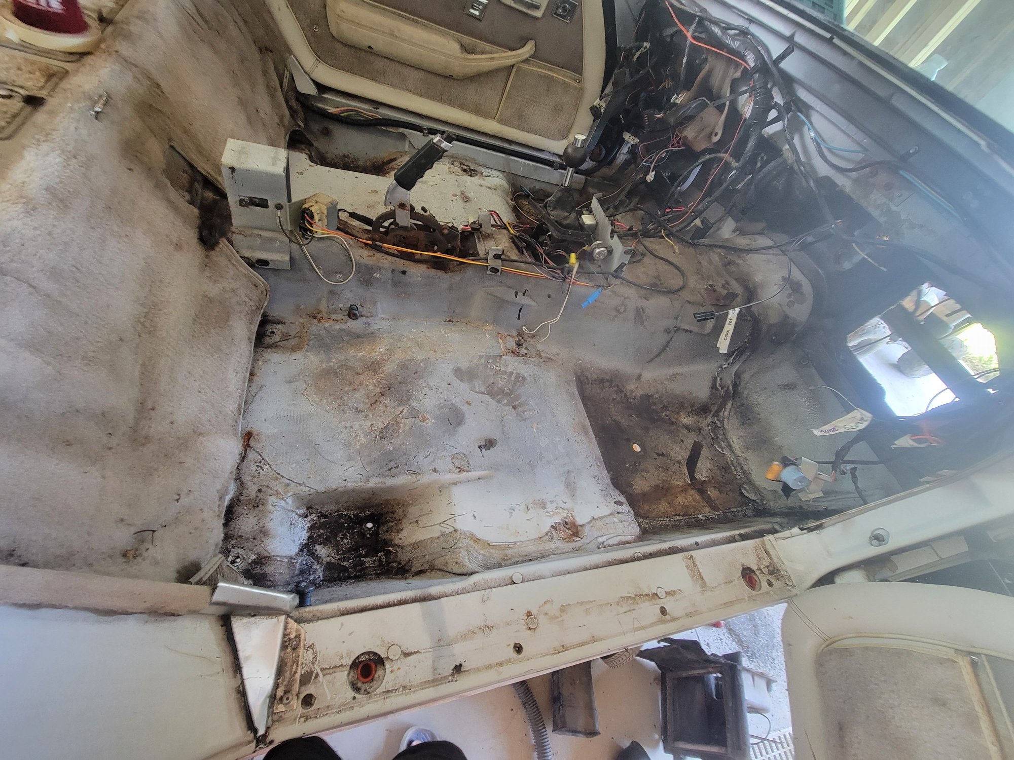

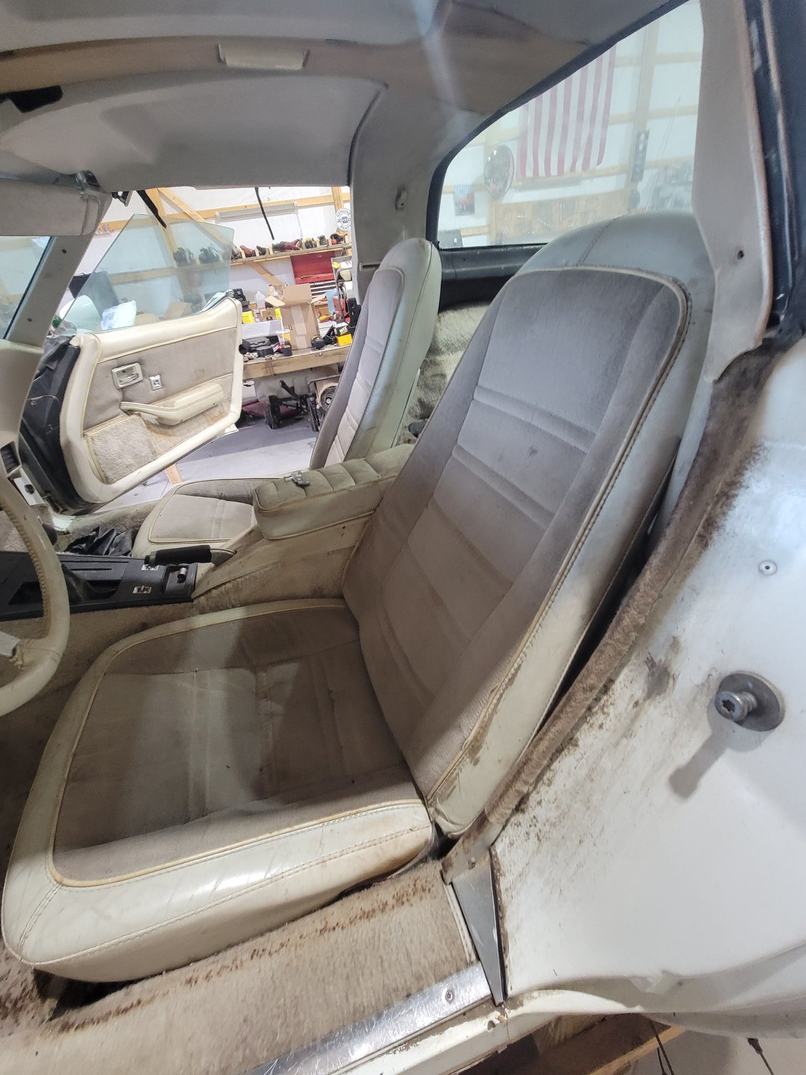

I still have some odds and ends to tie up on the chassis, but I started shifting gears onto the body. I've stripped out everything from the engine bay and got a good start on tearing out the interior.
It's kind of overwhelming seeing it like this. But I'm confident I will get through it and I know it will all be worth it!. I have a vintage air system on the shelf to put back in once I get everything cleaned up and painted. I also have a universal painless wiring kit to put in the car. And a Dewitts radiator with the dual spal fans on order

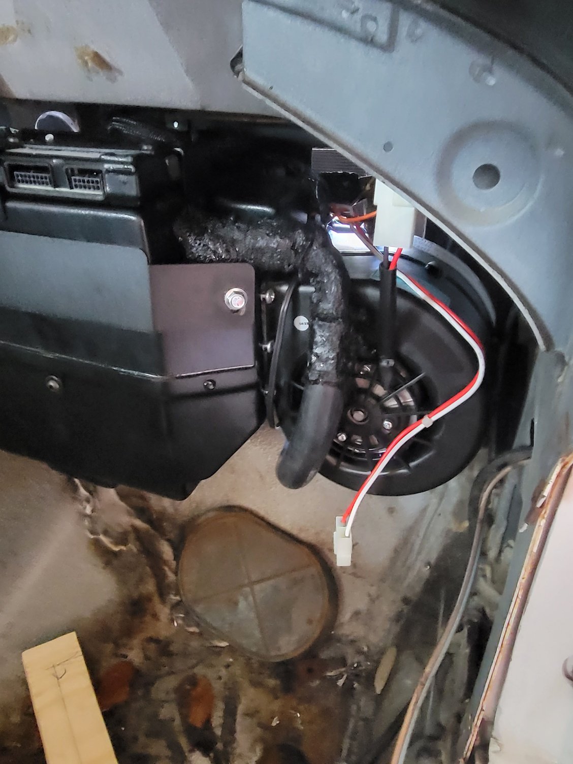

Lots of updates on my build. I got the engine bay painted.

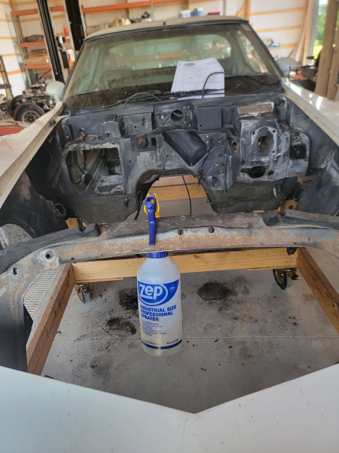

My core support was rusted out, so I replaced it. I started installing a vintage air system.

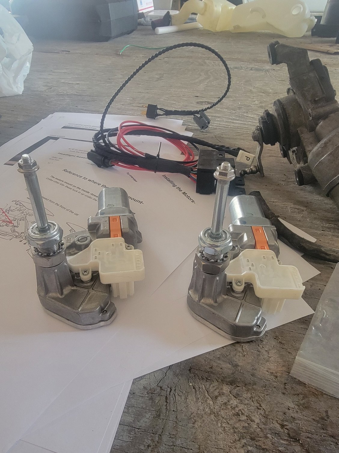

I got an electric headlight conversion kit from richard454

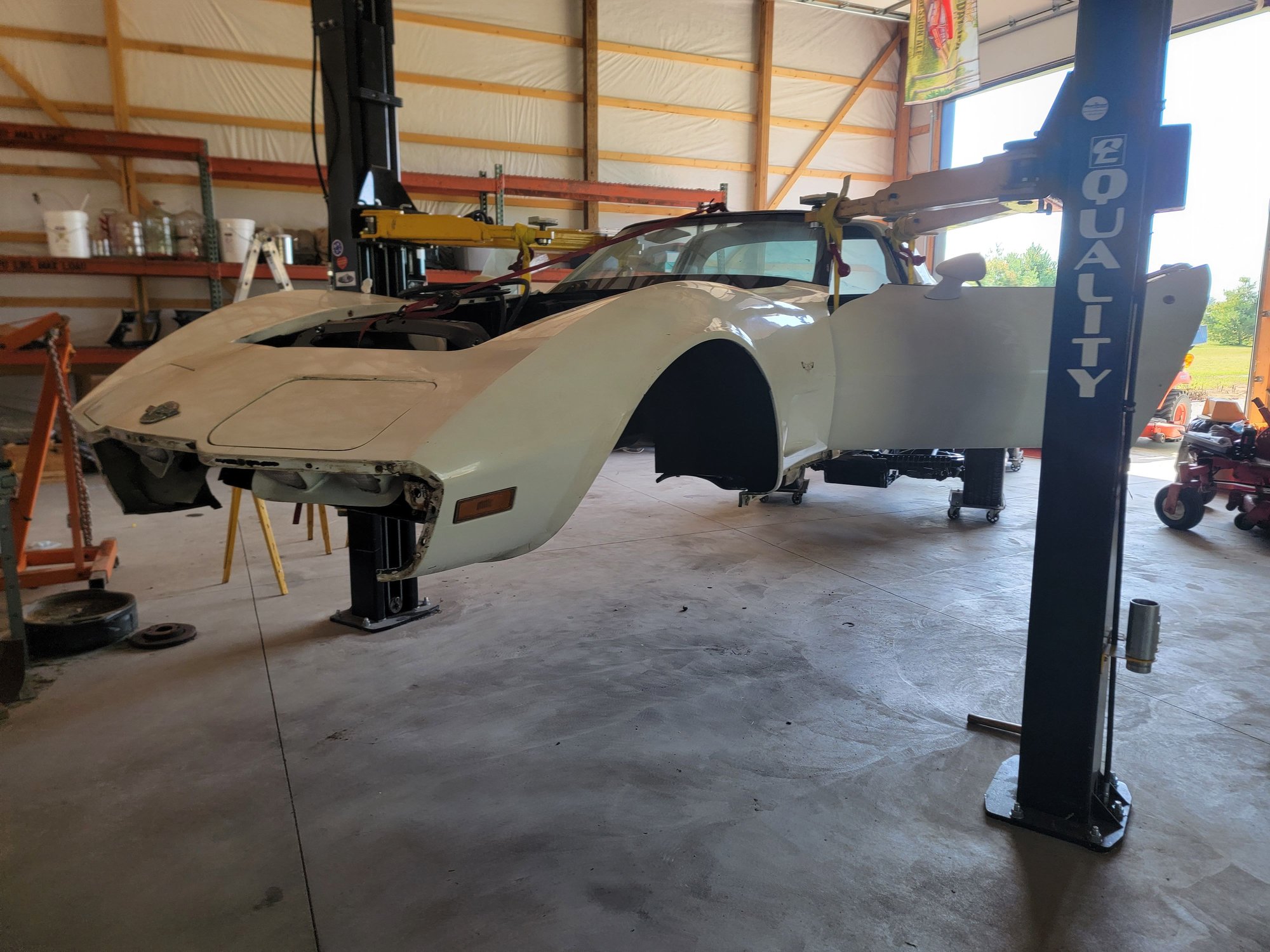

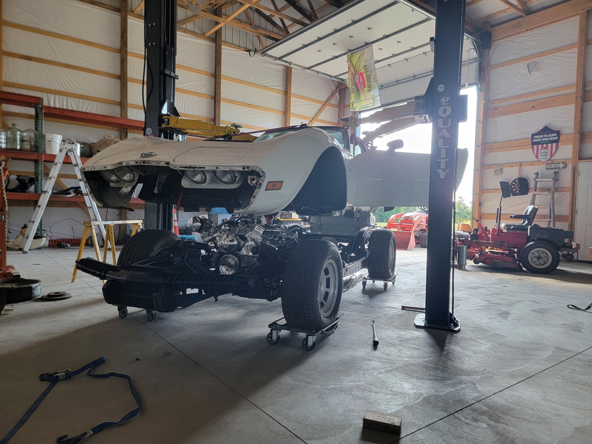

And the biggest milestone was getting the body married back to the chassis!
I still have a long way to go but I feel like I've beat the odds at this point. I've throughly enjoyed every step of this process.
