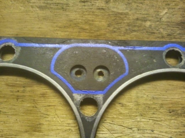

Originally Posted by johnt365
I hope you get it straightened out. You don't mention which gaskets you used but if you haven't used the Print-o-seal Performance ones from Felpro in the past, you may check them out.
There is a pretty big difference on the water passages for the center cylinders. Photo shows stock replacement on bottom and performance ones on top. To me this is a must have considering there are two exhaust ports right there building heat. Check out the difference:
I just had a set of heads pressure checked and some machine work done at Wolff Machine Shop. David is an honest guy who does good work. There were always several V8's around the shop and boxes of performance parts for builds.

I took my heads to Wolff Machine shop. Met David. You were right he is a really nice guy. He went over the heads and told me they were basically junk heads and always had cracks. He said $400 to inspect and clean them up. I am meeting a guy to buy some World Torker Heads for $300. He is going aluminum and the Torkers are cast iron and new. I figure that's about a good a deal as I can get for that price.
