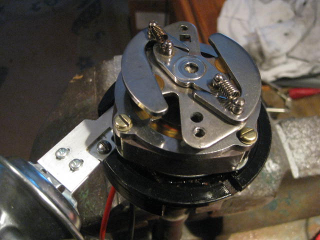

pic of mine:
Your inital timing: is this what happens when you set the total timing to 36° or why can you say you get only 20°?

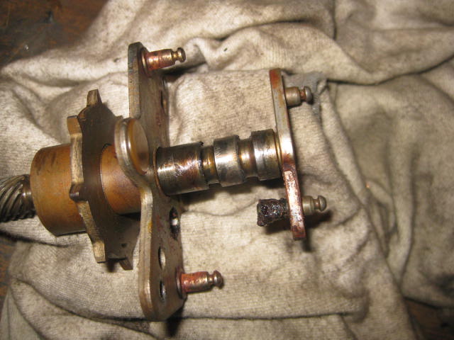

If this rubber bushing is worn you will get a wider mech. adnvance range:
But anyway you should be able to turn the dizzy until you get ~16 initial. And the engine should run even with only 10° but you may need more throttle opening to keep it alive.

I have the total set at 36*, but the initial is still 20* with vacuum advance unhooked. Can't get it below that without it stalling. I replaced the bushing with a bronze bushing. I'm hoping the new coil makes a difference. Order the coil today from Paragon. I like the advance stop you have on the vacuum advance. I'm going to have to make one of them. Thanks for the pictures.
