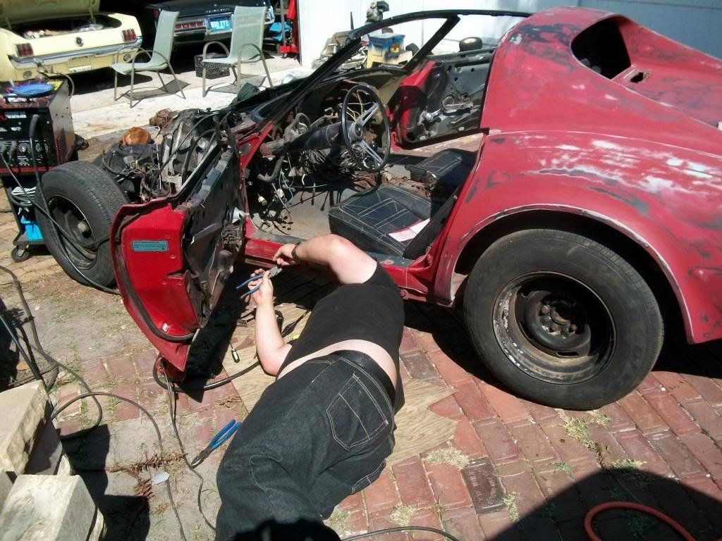

Don`t feel alone on the budget issue Larry! We also found a couple small holes on the door of our 71, but only on the front bottom corner of the driver`s side. Here`s my 16 year old welding in a couple small patches...As you can see in the picture, we`ve already done the windshield frame, new corners in it too.
