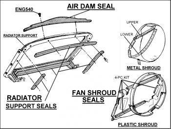

make sure all these seals are in place. the pix may not be exactly correct for your year. all the vendors have the sets. cheap, easy thing to check. took my big block 20 mins to overheat at idle before i installed these, and only a few were missing or shot. afterwards i couldnt get it to overheat.
of course all the tuning, radiator condition etc stuff needs to be addressed as well, but, if ur old radiator is good the seals may do the trick
hth

Excellent point! The fan creates a low pressure area inside the shroud. Any air that is coming in to equalize that low pressure area must be coming through the radiator for it to do any good. Air coming through between the shroud and the radiator is that much less air coming through the radiator. And engine cooling boils down to just two things: coolant moving through the cooling system, and air moving through the radiator.
