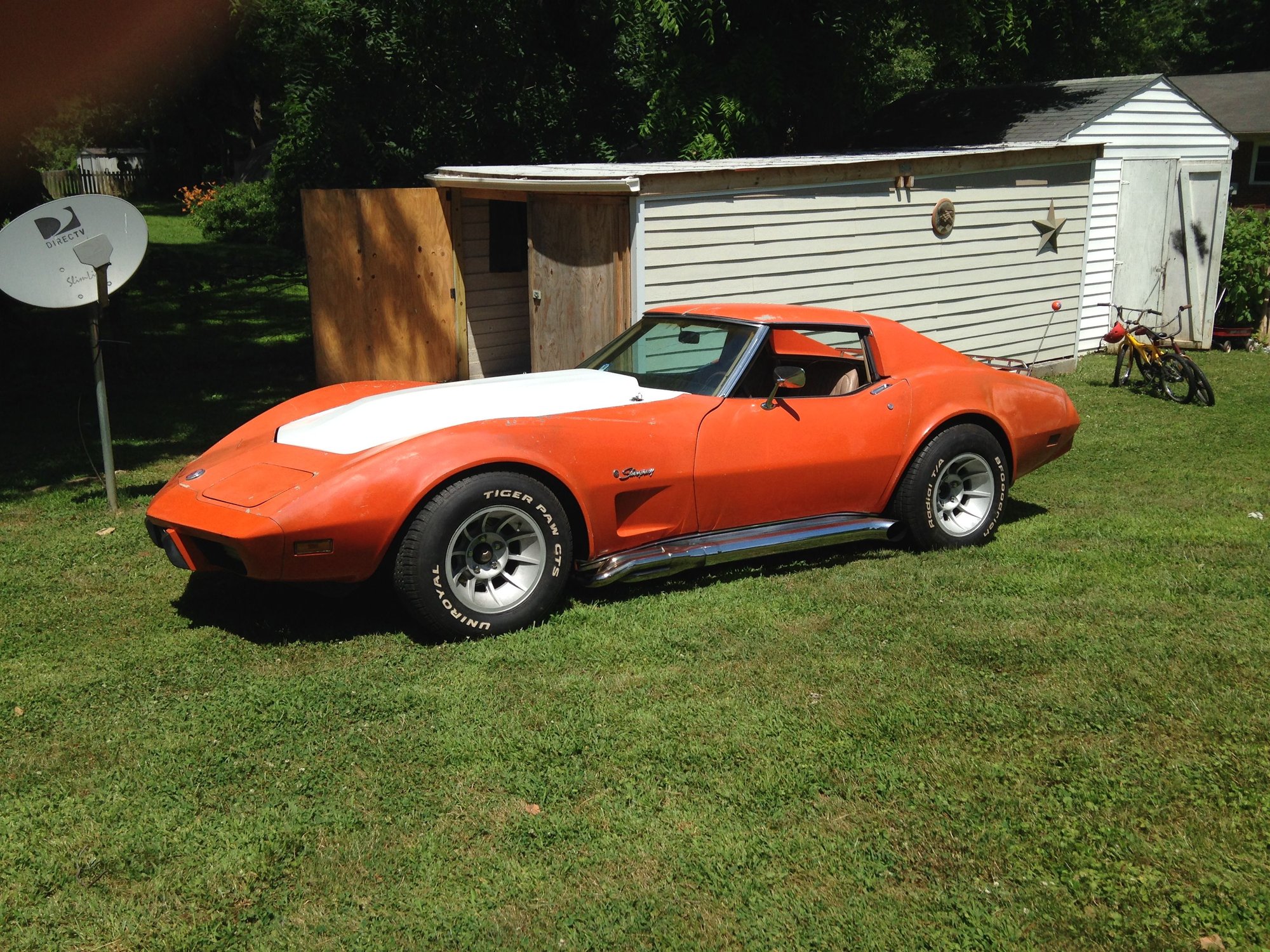

Default BBC in a SBC C3?
Was wondering if putting as BBC in a 76 Coupe is possible. Lots of mods or and easy swap? Can the 76 stock frame take the additional weight and torque?
Thanks,
Diesel

I'm starting to feel pretty encouraged about this project! I think I'm going to start looking for a BBC engine. Preferably one that has already been rebuilt...
Diesel
