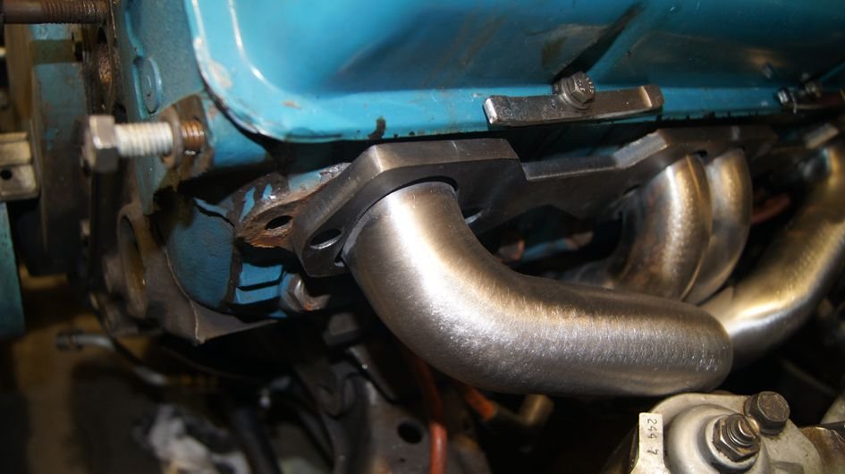

I just purchased some from sanderson but they dont fit on the driver side. This is a test fit before I pulled the motor. This is a stock L48. These are the CC134DP models made for my ZZ383. I hope they fit better when I put the ZZ383 in, but I dont think they will work. Not sure if any fit without some adjustments ?

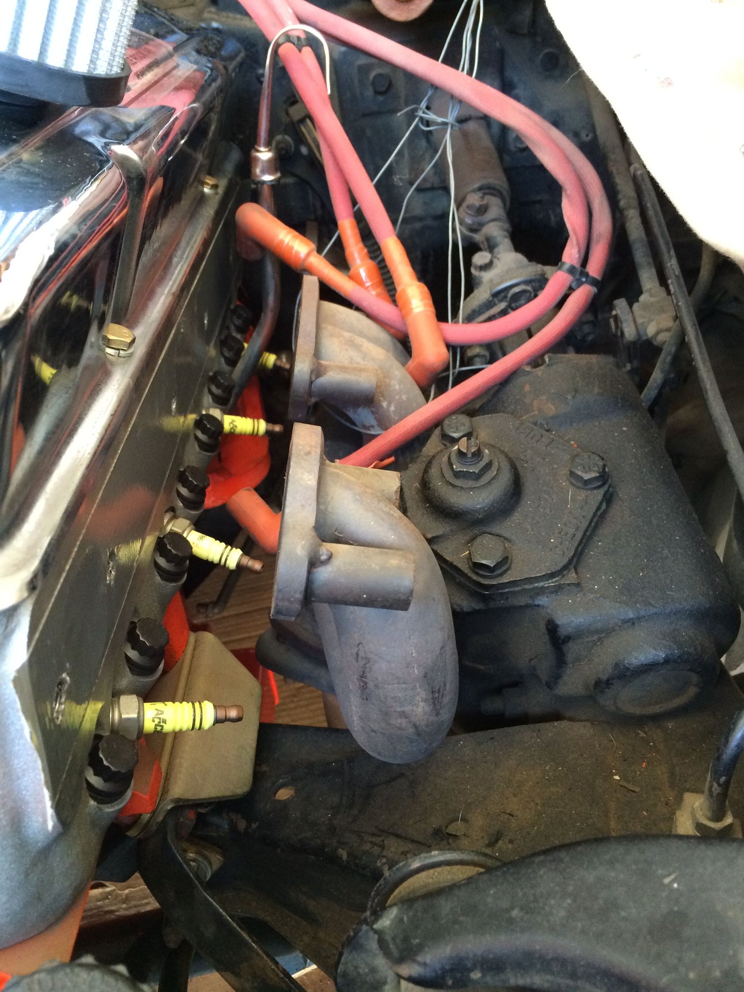

Lots of shorty choices out there. I was researching for my situation (angle plug heads) and found JBA 1815S, Flowmaster 814120, Hedman 68390, and Patriot H8052, with others available. I can't vouch for fit of the others, and just got the Patriot's a few days ago. I'm sure they will fit (so I say now...), but need to modify the head pipe to reach since they are so short. You can also look for take off manifolds from C4s/ That's what I had on the car before, and these should be cheap to buy if you can find them.
I have no idea what shipping would be, but I don't need mine anymore...
Passenger side with alternator mount welded on. F adapter is bolted on.
Drivers side, lots of clearance.

Edit to above. The Patriot H8052 fit the heads great, and the passenger side with lots of room, but they hit the steering box on the drivers side. Not sure if the H8065 or H8037 will be better, but I might try those next.
