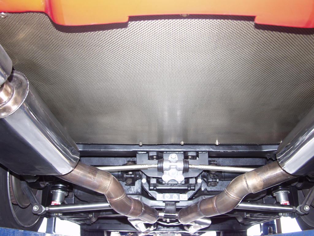

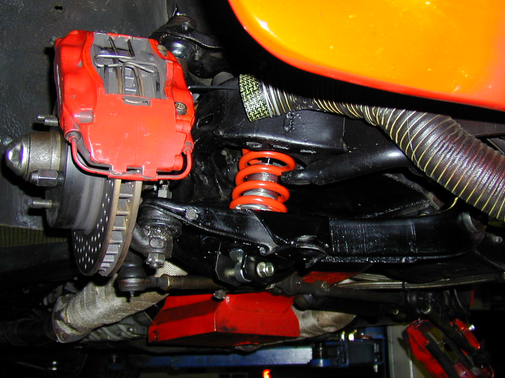

Here's few pics of what I'm getting and I'm going to try if it works with mono spring set up front and rear.
Sorry about the pic size...

If thats the kit from the Germanguys at ACP, I think its about $1700Euro for the front coil overs...lemme find the emai they sent me...
"Brembo-Kit front,contains 2 Brembo Calipers,Pads,Brackets and stainless Brakeline Kit 1600€ Brembo-Kit rear,contains 2 Brembo Calipers,Pads,Brackets and stainlees
Brakeline Kit 1700€
Both Kits are used with stock Discs (If you looking for "drilled" Discs you can get it at Summit Racing)
Koni Coilover-Kit rear,contains 2 Koni Racing Coilover Shocks,Springs,Brackets,Bushings and other Mounting Hardware 1560€ Koni Coilover-Kit front,contains 2 Koni Racing Coilover Shocks,Springs,Brackets,Bushings and other Mounting Hardware 1700€ Both Kits,specialy the front Kit,need some skilled welding and reworking!"
