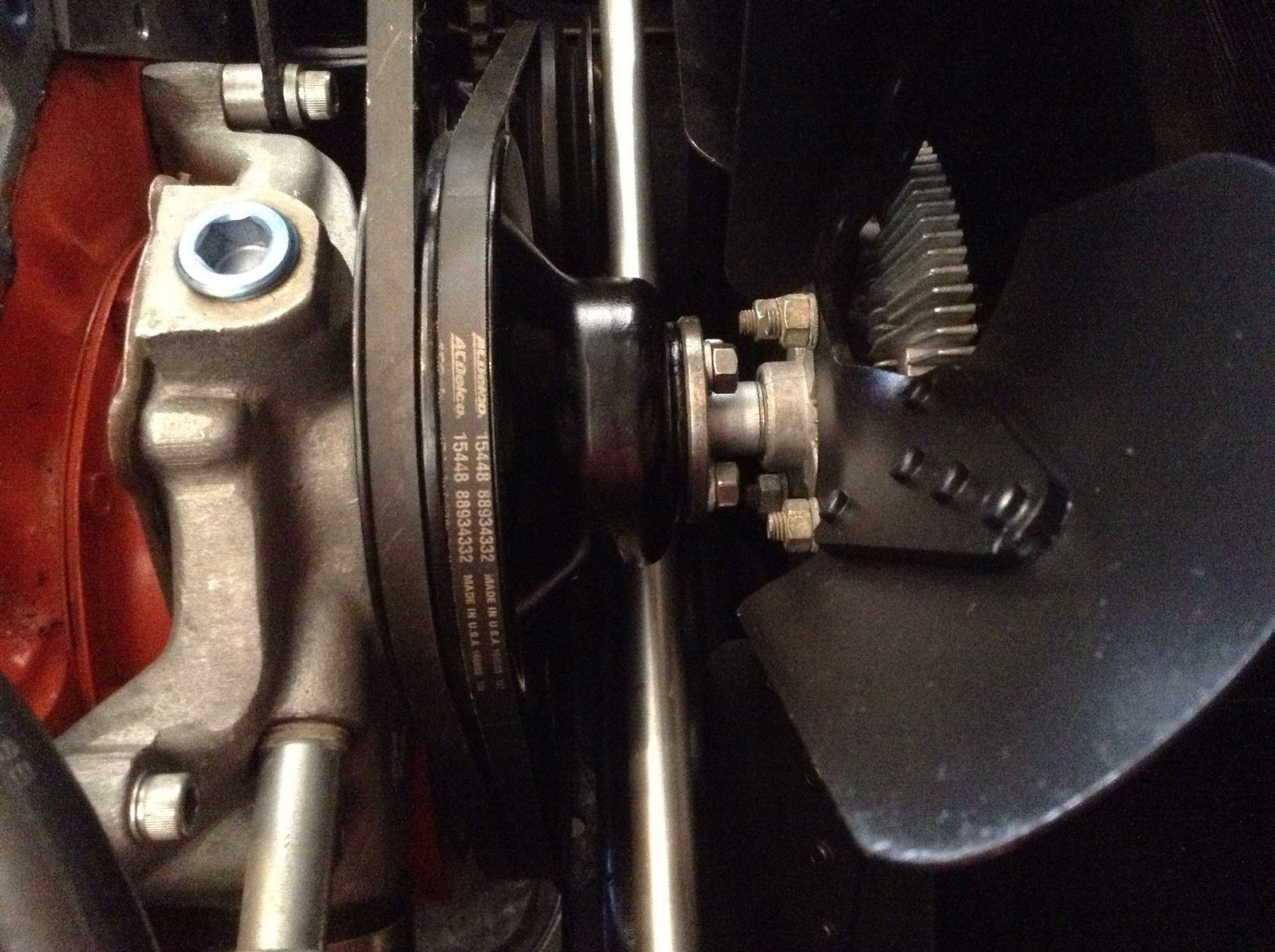

Here you go: Been on my car for about 5-6 years:

Its not much but has not been a problem for the last 5-6 years-no issues.
1/4 inch between the bar and the power steering pulley and 1/2 inch between the bar and the fan blades. Plenty of thread on the control arm threads-again-no issue.

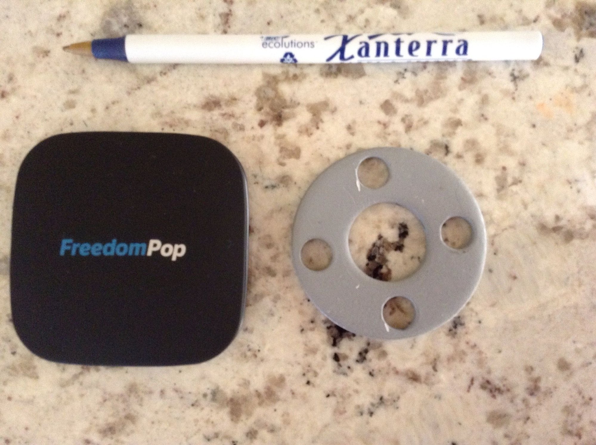

I have a two groove power steering pulley (single groove pulleys are about $100, so I'm kind do stuck with it). The pulley limits how far back the spreader bar can go. I had very little clearance between the fan and the spreader bar. It was fine at idle and cruise, but when I reved it, I could hear a the fan kiss the spreader bar intermittently. A 1/8" spacer between the w/p pulley and the fan clutch gave me all the clearance I needed.
Here is the spacer I made.
This shows the spacer mounted. I painted it black, so you have to look closely. There is no contact between the fan and spreader bar.

Pete, Have a pic of the bracket where its mounted on the control arm by chance?
Nice job on the spacer. Was it just a big washer that you drilled?
Pete
By any chance would you have a scetch with dim's for the spacer.
