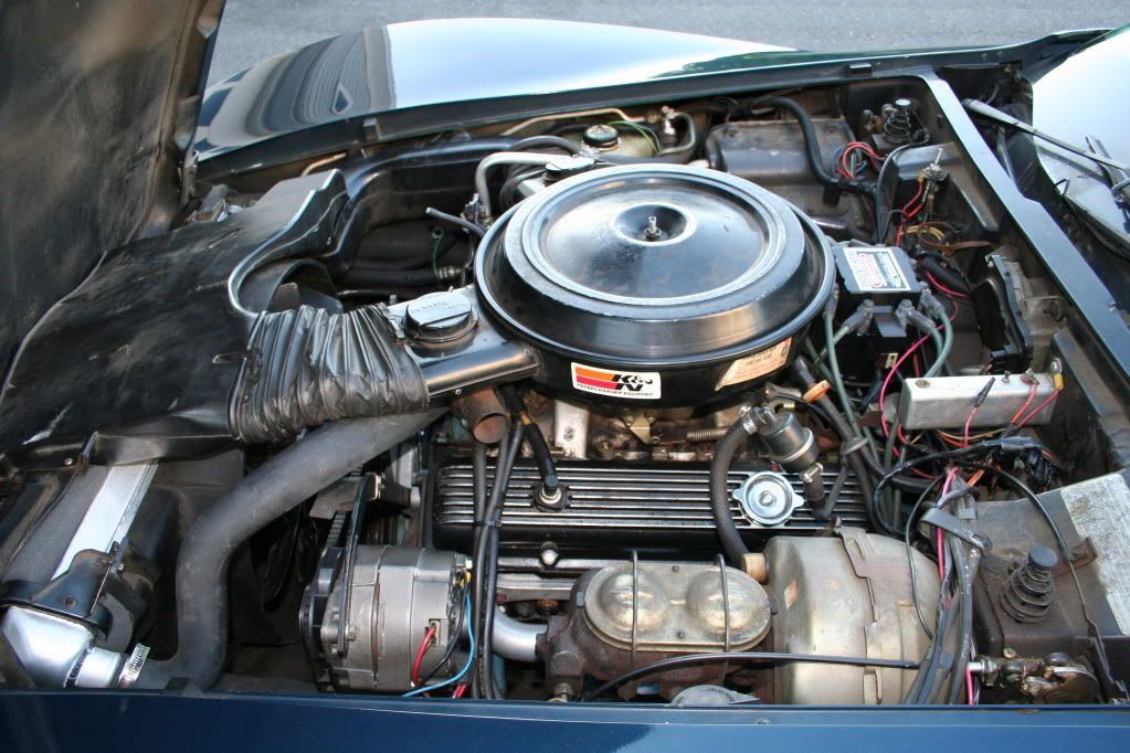

Cagotzmann, In the picture you have a air intake that is going over the radiator What Vehicle is this from?
Thanks,
Tim
Thanks,
Tim
That is stock from my 78 corvette.
Thanks,
Tim
Yes, that is the cold air dual snorkel air intake assembly (L-82) used in 78 without the flex hose to the stock air cleaner. I believe the L-48's in 78 had only a single cold air intake. I just totally rebuilt my OEM L-82 using the OEM block (all numbers match-engine-4 speed - Vin) and purposely retained as much as possible from the OEM L-82 (it looks pretty close to a stock L-82) BUT it is now a 355 with Forged JE racing pistons/rings, AFR 180 64 CC aluminum heads, Howards Roller cam-.525/.525, duration 219/225, LSA110, and 10-10.2:1 compression. The goal was to retain as much of the OEM L-82 as possible (example of the stock dual cold air intake), make it look like a pretty stock L-82, and make the HP of a crate 383-Mission accomplished! The "new" L-82 is beast.

Thanks, the reason I ask is I'm doing a LS conversion with my frame off and looking to find a way to get air from in front of the radiator to the intake that does not look crazy.
Thanks again
here is a better picture-totally stock-78 L-82::
