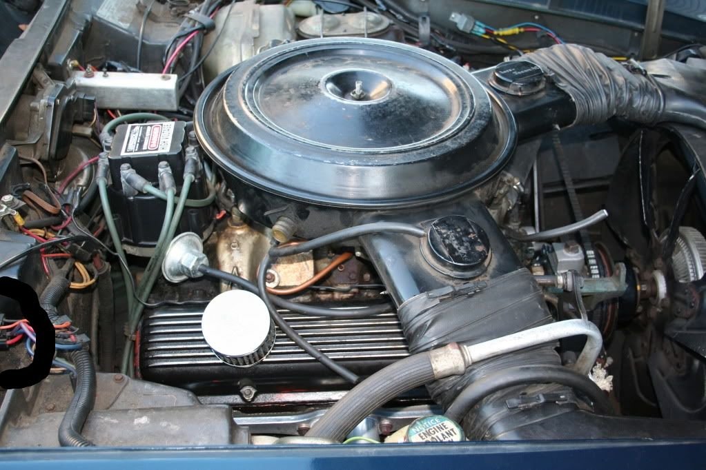

Mike,
The wires go into 2 relays on the 78 in the location of the picture. The bottom relay is the one that controls the fan-just pull the plug out and the motor will stop running continuously. Let us know how you make out.
