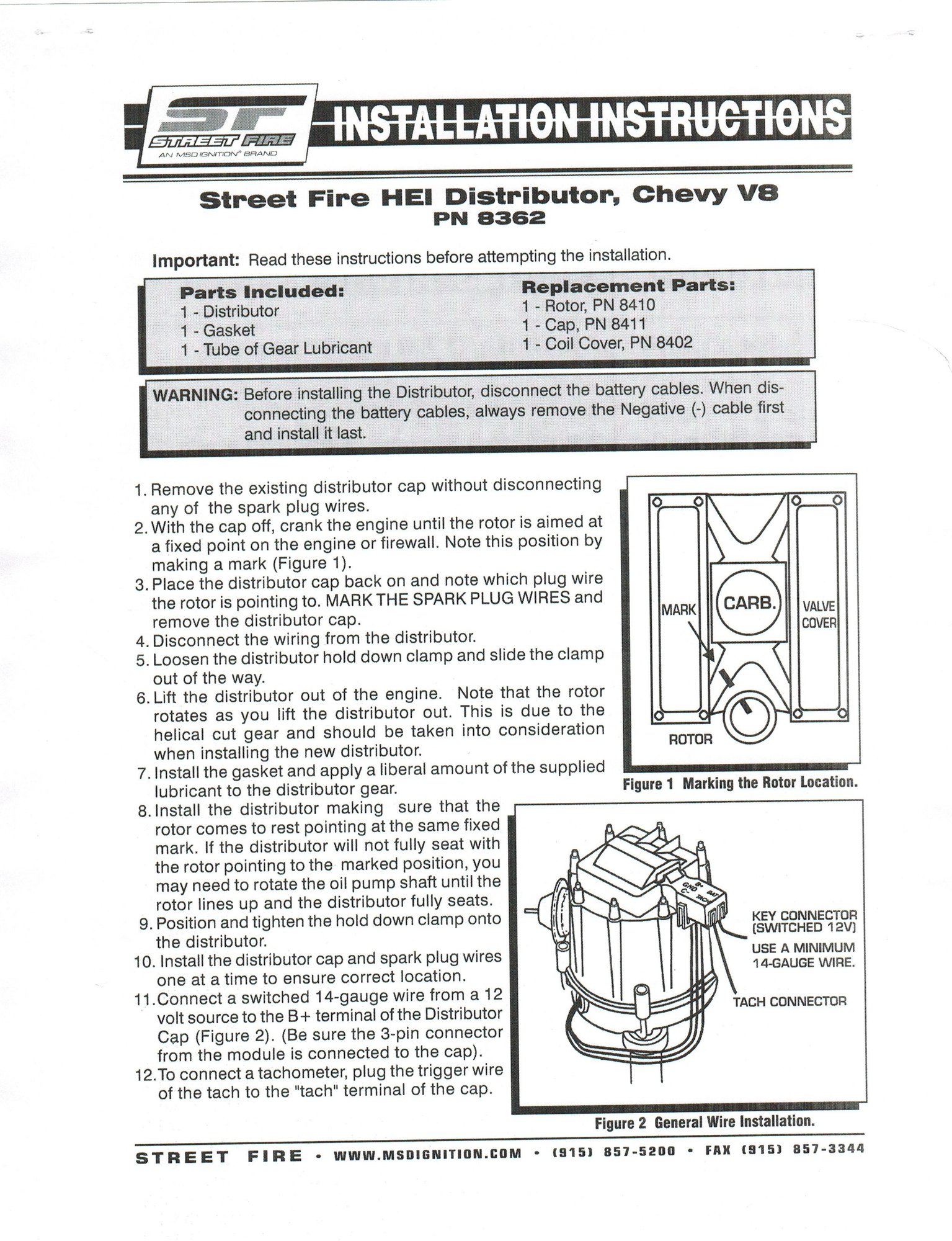

I have an aftermarket distributor and I need to adjust the vacuum can a little to stop some part throttle/midrange spark knock. Which way do I turn the adjustment (small allen wrench through the vacuum port) to decrease advance? Of course, the dizzy had no paperwork with it. Car runs great otherwise.

try these

This is the one I installed, Accel. Likely same unit as above.
http://shop.accel-ignition.com/adjus...points-v8.html
Click on the "Instructions & Troubleshooting" banner and you will get a .pdf file.
The only other change I made was to mechanically limit the degrees of advance and only used the adjustment for the vacuum required.
I found that 15 degrees of advance was about all I could do, without surging at cruise speed. I limited the advance to that amount by putting a "restriction" on the advance shaft.
After adjusting, 12 inches of vacuum seemed to be the best.

Thanks from you both. Exactly what I needed!
