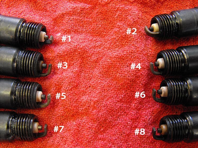

Hey all,
Did a compression test this morning. I'm showing 150, 155, 160 across the board.
Plugs: As I mentioned before, I had one plug (#4) that looked very lean. Since that time I have driven the car some (before I noticed the coolant being low etc.). When I pulled the plugs today, they are all much more consistent, although still appearing to be lean in general (very slight tan color, but on a few this is only in a spot or two and the rest of the plug is white).
Coolant: When I pulled the radiator cap, I got a release of pressure into the overflow tank (heard bubbling in the tank). The motor was cold at this stage and had not been run in about two weeks except this morning to move the car to the center of the garage, which only took about 30 - 45 seconds. I also found that the coolant is still bright green, but I had a some small brownish colored bubbles floating on top of the coolant.
Again, please check my thinking on this, but given the coolant pressure and brown floating bubbles, it's looking like a head gasket / head issue to me.
Is there something else I should consider or do which might possibly help with the diagnosis?
Thanks in advance for any help,
Adam
Edit - shot of plugs
Old Aug 23, 2014 | 04:55 PM
bluedawg's Avatar
bluedawg
Joined: Jan 2009
Posts: 3,736
Likes: 56
From: anchorage ak
Sounds like a head gasket to me also.

I ran the car up to full operating temp (shows 190 - 195 on the gauge) Actual temp with an IR gun is 185. Tested it off of the radiator directly, and found NO exhaust gases in the cooling system.
With that said, I still have an issue, but this test eliminated the head gasket / cracked head from the equation.
I did discover another problem in that when I started the car (cold) with the radiator cap off, I immediately had coolant flow in the radiator. This tells me my fail-safe thermostat is stuck open, which is what it should do if it fails. Will have to replace that for sure. I'm also going to flush the cooling system and put a new radiator cap on it at the same time. Both the cap and thermostat were replaced when we put the new motor in at the beginning of 2012, but that doesn't mean they are still OK (obviously).
The other part I'll replace is the coolant overflow cap. That cap is part of the recovery of coolant as the motor heats up and cools down (fills up as the coolant expands and then the radiator draws coolant back out as is cools off).
While I'm doing this I'm going to crawl under the car and inspect the radiator for leaks just in case.
Something isn't quite right, but there was zero change in color of the chemical in the block tester, so that's a very good sign.
Adam
