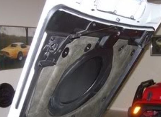

Originally Posted by fgp73
I had to have had one of the hottest (temp wise) Corvettes on earth. I've had it for 5 years. It is a 73 4-speed small block L48. I put the heater core shut off valve on a year ago, but still had heat. In doing more research on this forum and other sources, I found 3 things I could do on my own since I'm not a mechanic, but I'm somewhat mechanically inclined.After doing my research and examining my car for the umteenth time, I found out that I'd didn't have 1) a lower shifter boot 2) a trans tunnel foam gasket 3) a hood weather strip gasket. I just finished replacing all three and it made a huge difference. My shifter **** and parking brake area used to be too hot to touch. Today, the shifter **** was actually cool. I don't have any of the reflectix under my carpet, so I still can do that. I just wanted to share and say thanks to anyone who has posted those helpful hints because they sure did help.
I have a 78 and would like to know if you could post a picture of the hood weather strip gasket???

This isn't mine, I found this pic on the internet...you can see it better on a white car
