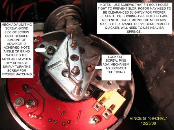

I limited my mech'l advance according to this article:
http://www.crankshaftcoalition.com/w...EI_distributor
Go 3/4 of the way down the page to "Mechanical, aka "centrifugal" advance".
Here is a pic showing the limiting screw on the left. No welding/brazing required.
Just tap the exisiting hole and file the edge down on a screw until you get the desired mech'l advance. Mine is limited to about 13* mech'l and 19* initial for 32* total.
