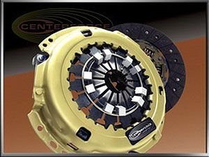

The only time you would normally see weights attached to a pressure plate is if it were like this...
The purpose of these weights is to increase clamping force without increasing the pedal effort. It is referred to as a centrifugal weight design pressure plate. As RPM increases the clamping force is increased. Otherwise the Pressure Plate would normally be neutrally balanced when sold.
Good luck... GUSTO

The weights I refer to are small washers rivetted to the pressure plate (Hays) or some small pieces of steel spot welded on one side (unknown brand). They appear to be for balance.
I'm aware of the Centerforce clutch which uses weights to increase clamping pressure. In this case the pattern would be symmetrical to stay in balance.
