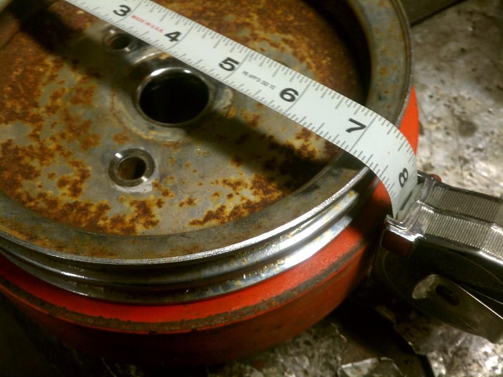

I went ahead and tried a Corvette 350 pulley.
The 350 pulley fits on the 454 balancer easy enough. It is even a little bigger than a Big Block pulley!
A stock 454 looks like this. And yes, I could probably force the belts on, but I really need a little more room to feel comfortable.
Anyone know a part number for a slightly smaller, maybe 7 inch 454 pulley?

Got this billet aluminum pulley for 46.00. It fits the 454 harmonic balancer perfectly. 6.75 inches across.
Some of the pulleys for this motor are pornographically expensive. It is possible to get one cheaper, but this one seemed a bit nicer for not much more money.
