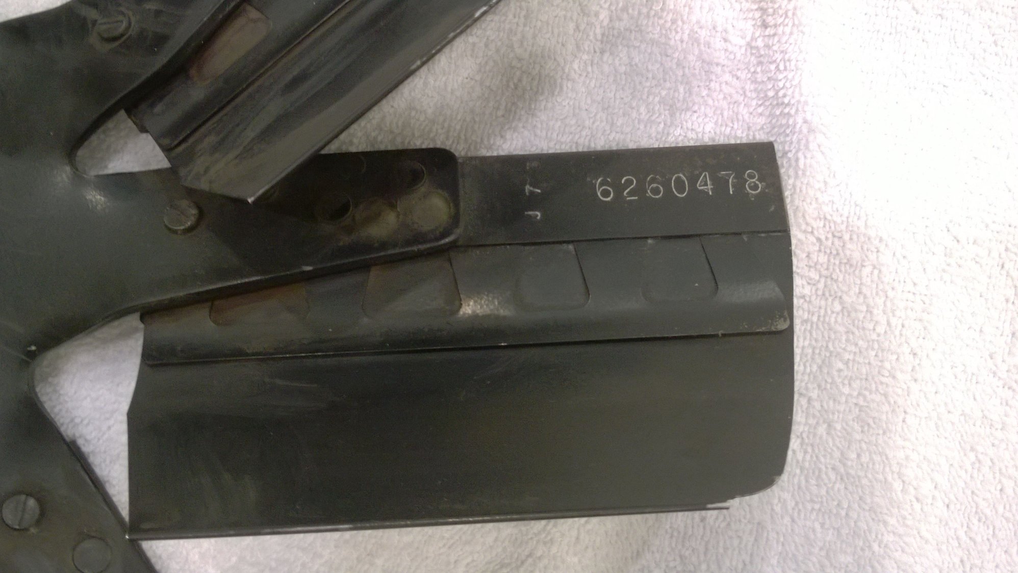

Yes, It is a real flex-fan. You can bend the blades. For anyone that cares, the GM part number is 6260478. The center hole is 5/8" and it has the larger ( 2 1/8" ) pump bolt spacing. I had to drill new holes for it to fit on my smaller 1 3/4" bolt circle. I will try to post some pictures tomorrow. I wish it was easier to post pictures on this forum. Everyone isn't a tech wizard! Most of the guy's that I worked with in my automotive parts plant , for 34 years until it closed in 2007, in maintenance and my age, would not even TOUCH a computer!!! Lou.

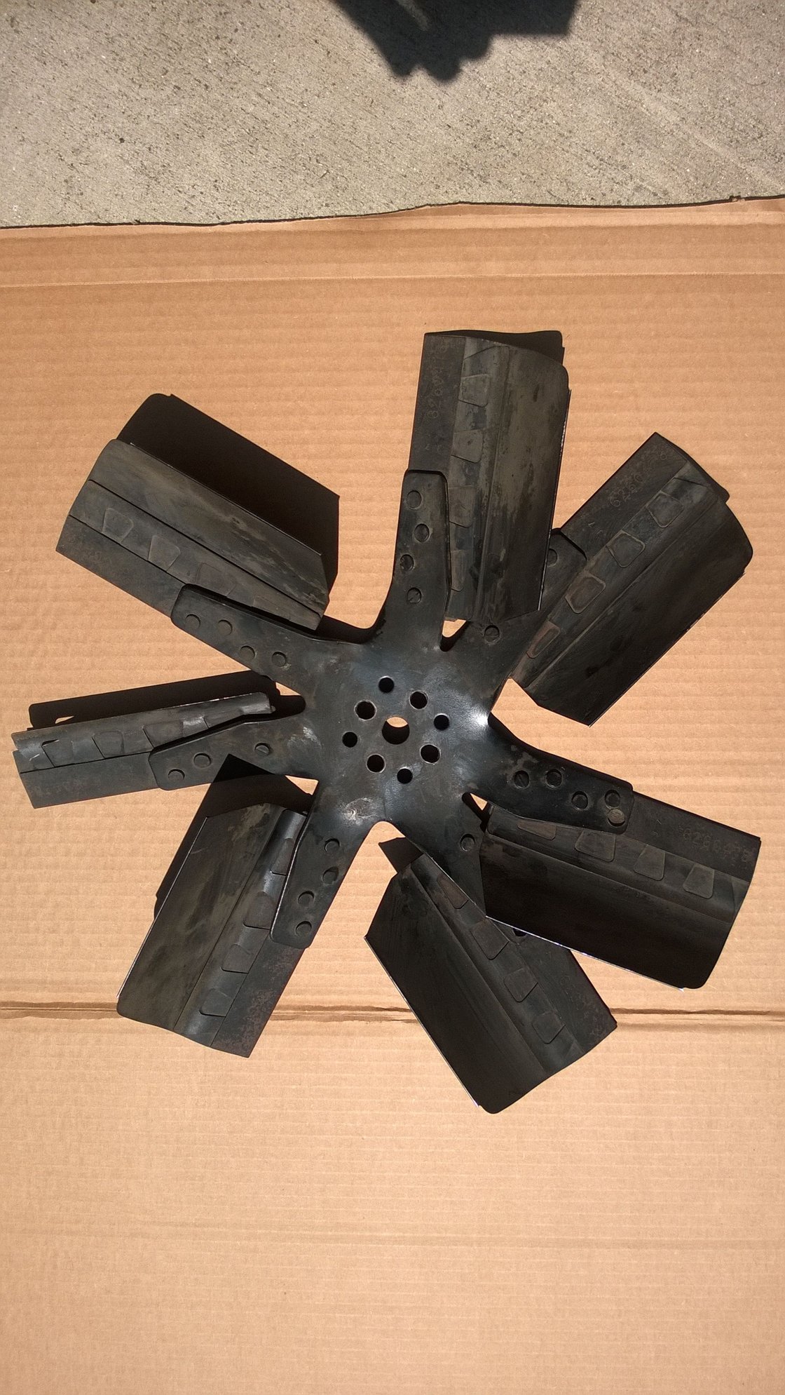

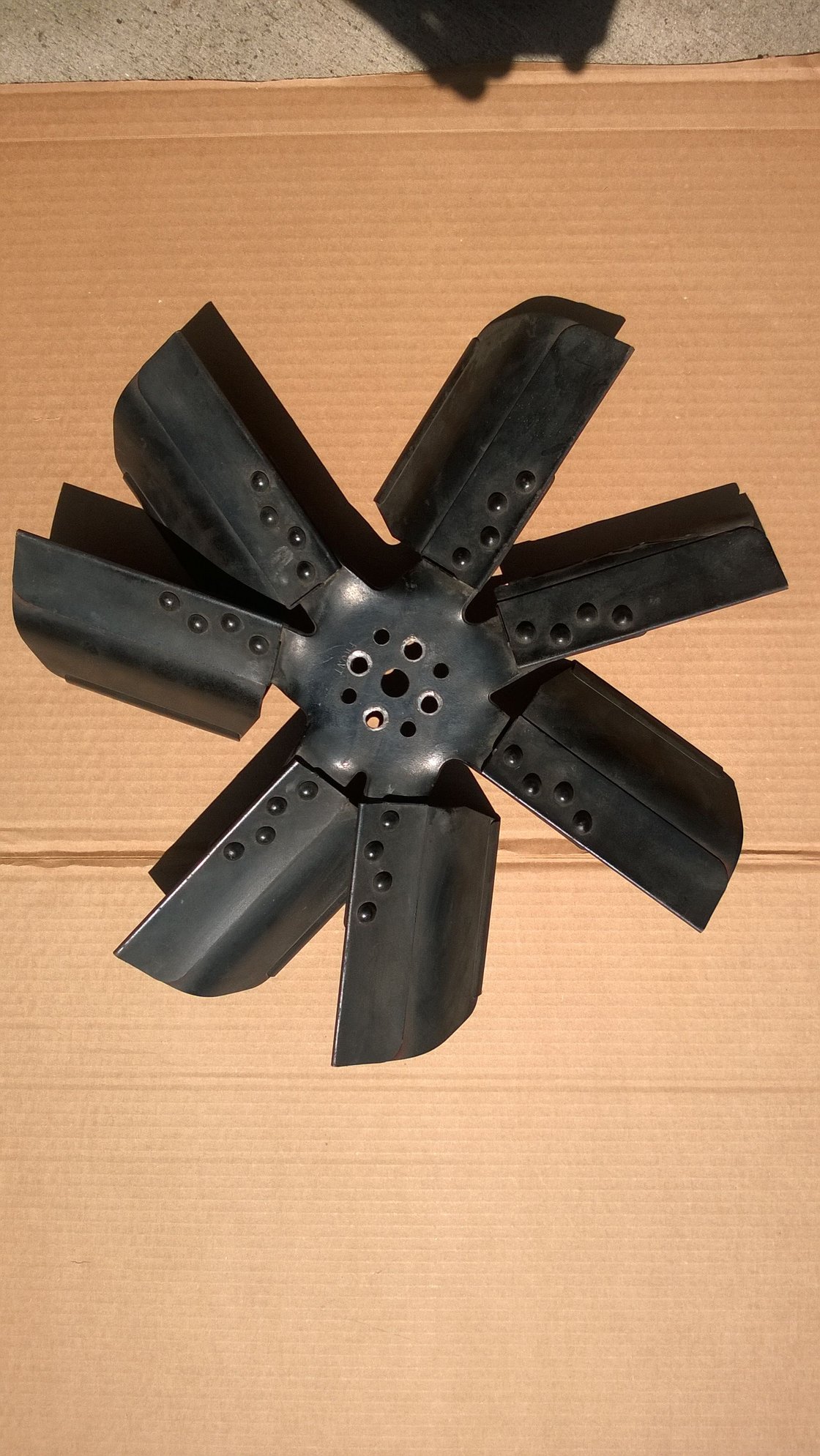

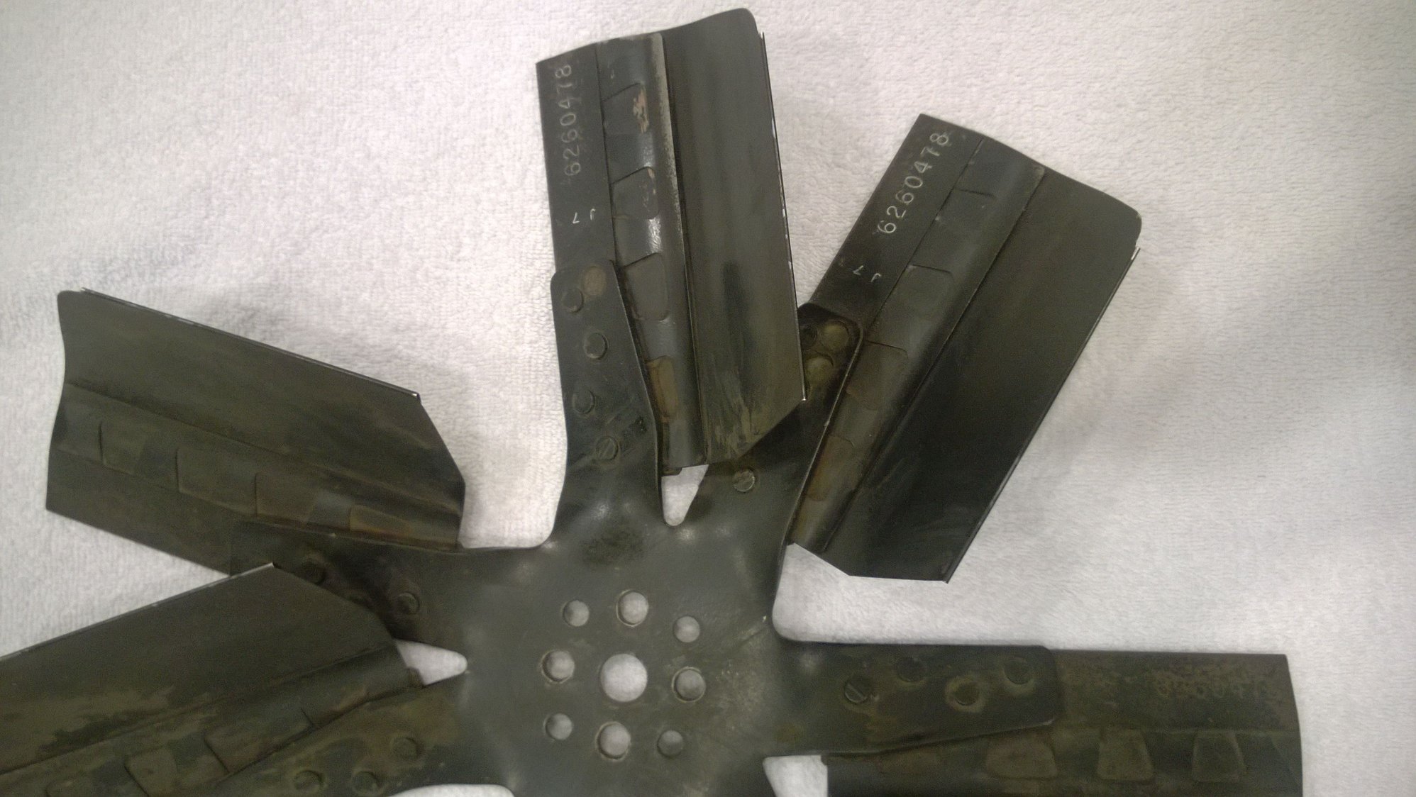

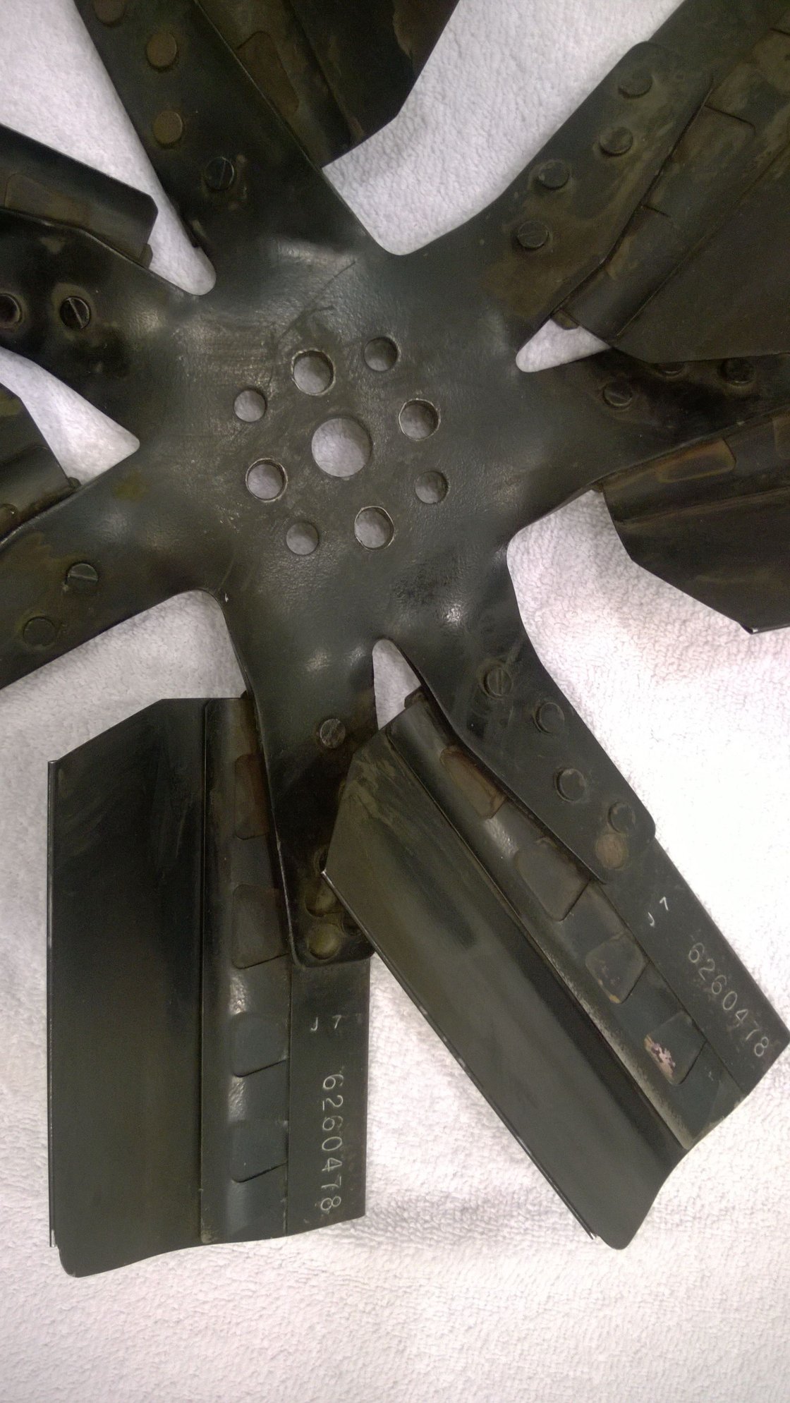

Flex fan GM number.
front of fan.

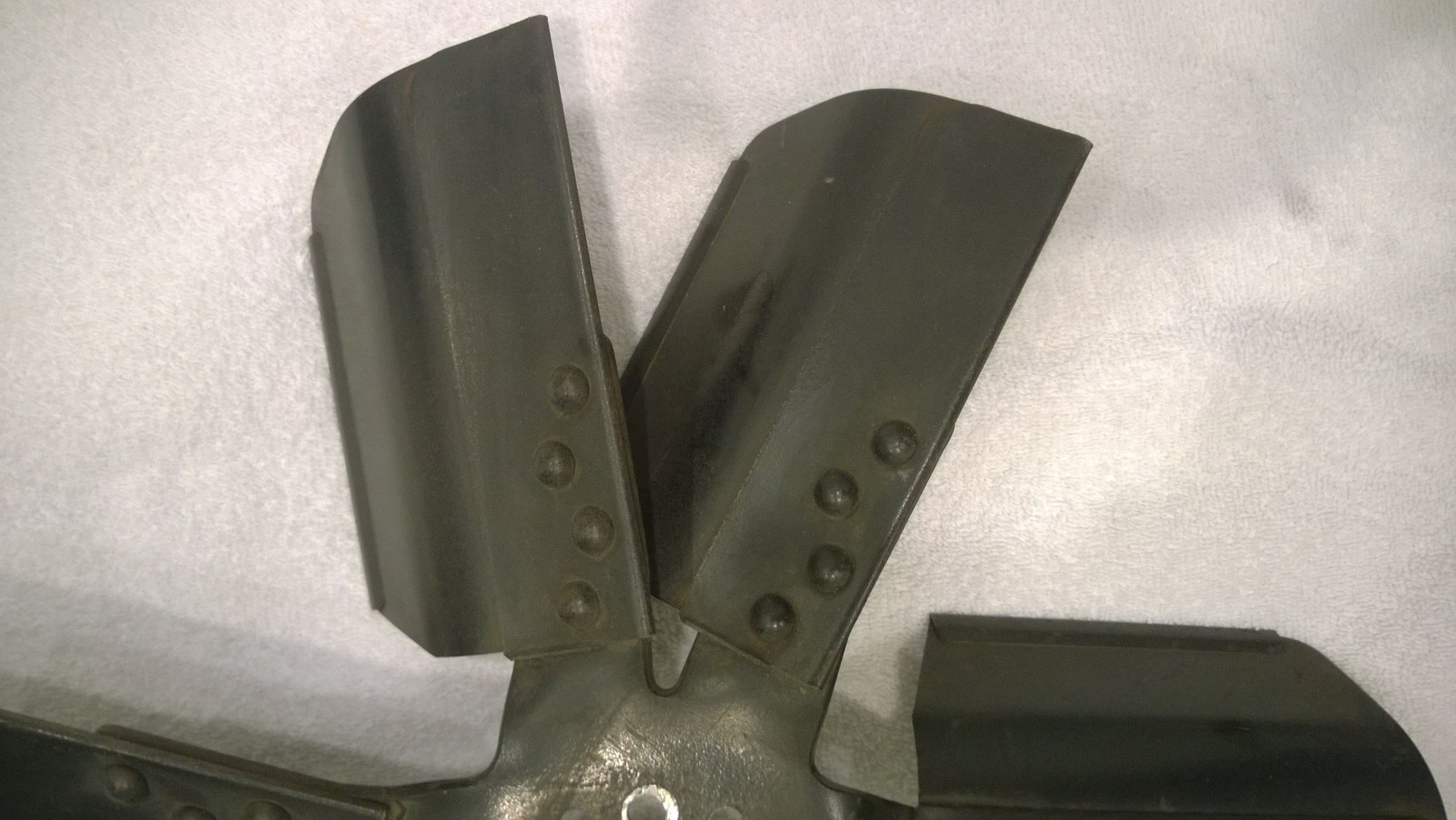

I told you guy's that it was a flex-fan! I had to cut the bad fin off, so I did not cut a finger off. Lou.

You are welcome, Mike. I kept reading, emphatically, that GM never made one, but I knew I had one! I know that they were meant for low revving big blocks, but I use to take it up to 6,300 rpm with my L-79. I just installed a new Dewitt's aluminum radiator into my 68 coupe, and I went to clean this fan and found the one fin cracked half way across. I am really glad that I just did not slap it back into the car. You really can't see much with the shroud on. Lou.
