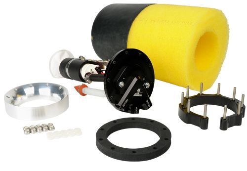

i run a low pressure pump that keeps a swirl pot full, a high pressure pump pulls the fuel from the swirl pot to feed the motor.
aeromotive make an interesting looking setup to
http://aeromotiveinc.com/products-pa...h-fuel-system/
Nice piece but ouch that price hurts. The 82 tank with 85 pump will support 400+ horse power with a TPI set up but after that, the aero motive will be needed.
Make sure you are using the highest quality fuel line and you will also need a filter in line.
