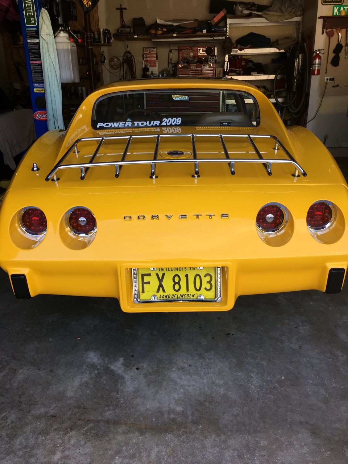

LED made by Grote, inner has the back up light integrated.

Not exactly plug and play. Mine are held in by the plastic chrome trim rings that I modified to fit the openings.
