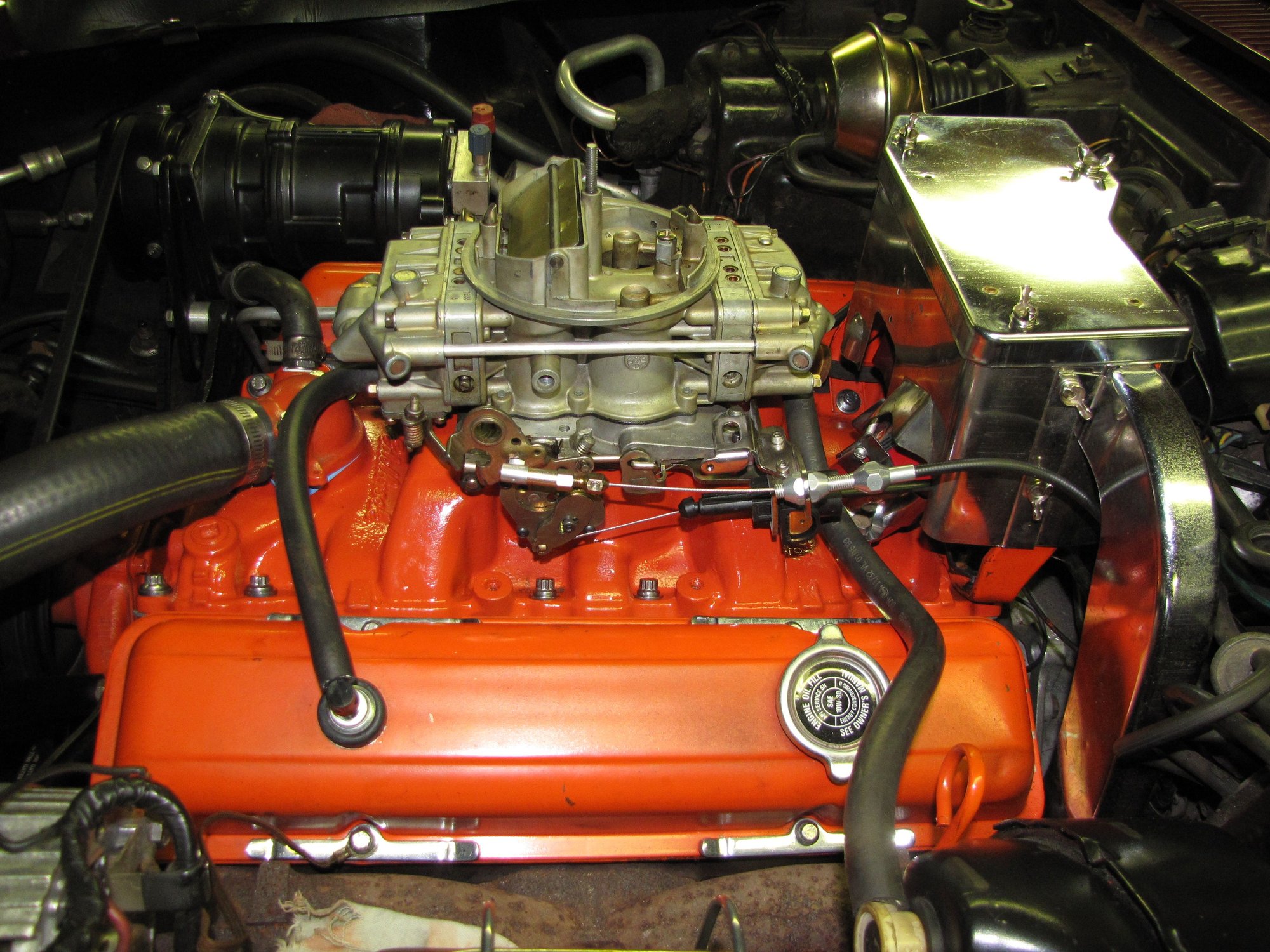

Need to replace my Holley 6210 650cfm spread bore carb on my 68 327/350. Any opinions on replacing it with the same vs a Rochester quadrajet? The car is overall stock and I'll be using it for kicking around town and for some short highway runs. Holley is real familiar to me for working on if need while but Q jets seem more complicated. I'm thinking a Q jet might be more fuel efficient and peppy around town but Ive always liked the Holleys.

thanks for the info. My Holley is probably 30 years old and was not used for some time. I rebuilt it via a kit and have been having low vacuum and idling issues. i have taken it on and off 4 times so far to check on possible issues. all port/vents flow clear. Just replaced my power valve with another one which seemed to help my idle but stopping at a light the RPM drops down occasionally to almost stalling unless I feather the pedal. Vacuum still is low about 10. I have checked the manifold carb/ mounts via propane to pickup on possible leaks areas, checked hoses, vacuum connections etc. with no luck. Local mechanic feels problems probably stemming from carb and suggested I just replace it. he favored quadriajet over Holley for around town responsiveness but felt either was okay. I know opinions vary just checking to see others experiences running one vs the other.

The throttle shaft bore is probably worn out. An unpredictable idle in the absence of any other defects is the symptom. It can be fixed. Try the propane specifically around the throttle shaft.

I'd like to stick with what I have for an easy swap. Holley 6210 650 CFM.
I'll try the propane again as suggested around the throttle shaft. Would this also create a vacuum problem? Mines running at 10. Ive checked all over the place with no success. Even did the smoke test out of despiration but smoke just comes up out of carbs primary and secondary bores. Hoping a carb replacement will fix problem.

Yes... a very worn throttle shaft/bore will cause low vac. Give it s shot. You can't lose anything.
