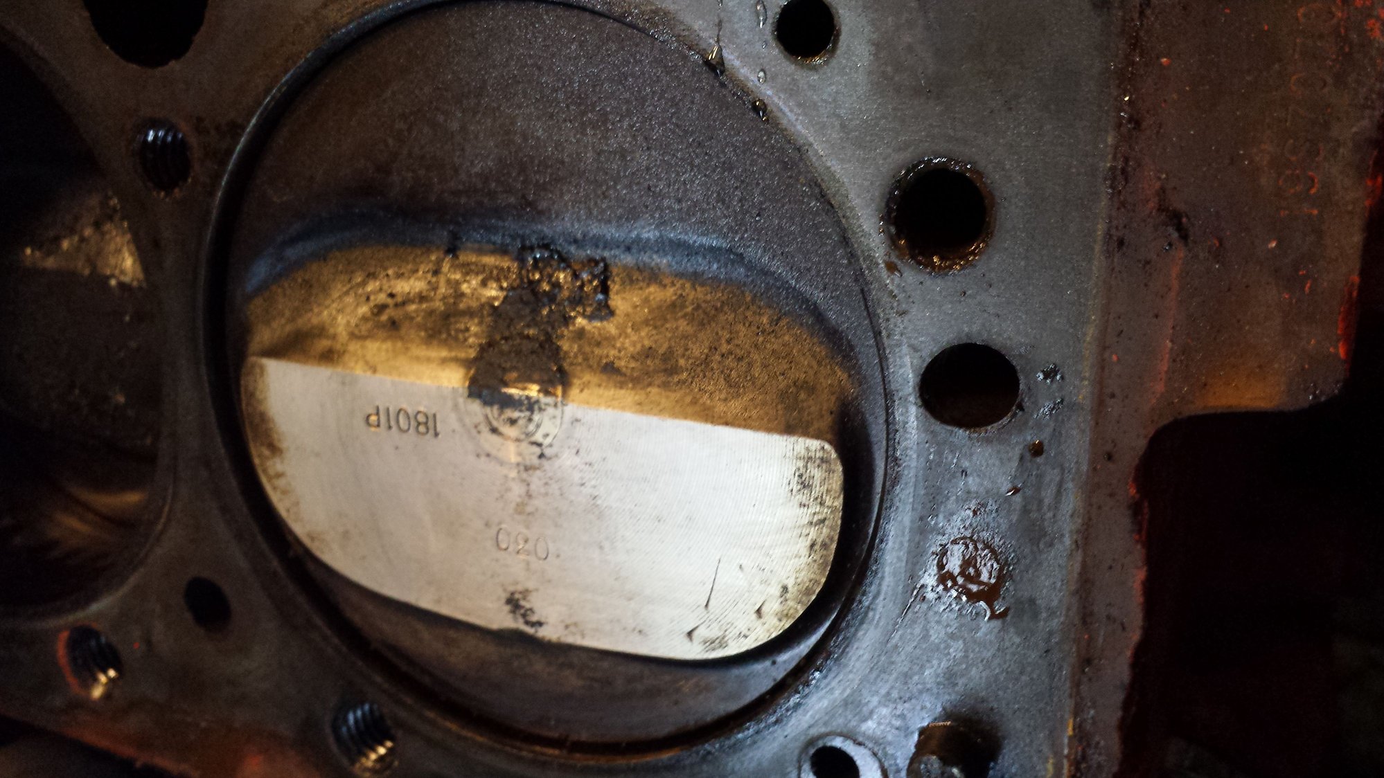

This is a 3cc dome piston right??

Those appear to be a set of TRW (look to be forged) stock replacement L46 pistons
About .100 dome height, depending on the heads, somewhere between approx. 10.5:1 (77cc) to 11.?:1 (64cc) ish
The .030 means the engine has been bored oversize .030"

It is 186 64cc heads, 11:1 engine.
Also do you know what the cc is for std. sbc 8.5:1 1971 corvette pistons?

The L48 had a small dish with the valve reliefs (4 I believe) and 76cc heads (you could get close to 9:1 with a set of 64cc heads)
I don't know the cc of the pistons but if I had to guestimate I'd go around xxxx (see 63Mako's post below) but I've never measured one
A 2403 used to be sort of a standard replacement, specs for those should be out there somewhere
M

L48 has a 16.9 CC dish.

2.4 cc net dome volume. This is the difference between the dome volume and the volume of the valve relief trench. The flat top version of this piston (1971-1972 LT-1) has about a 6 cc valve relief trench.
