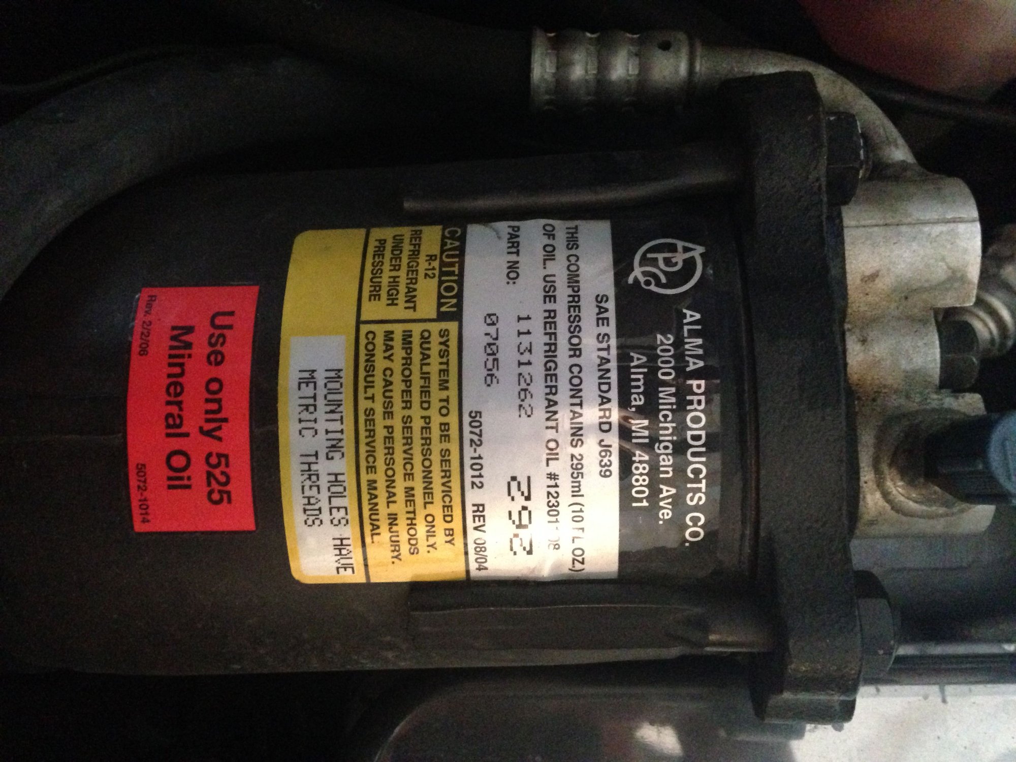

Originally Posted by mysixtynine
Do you know what brand aftermarket system it is?
Looks like it may have just been the compressor. Alma Products, pictured below.
