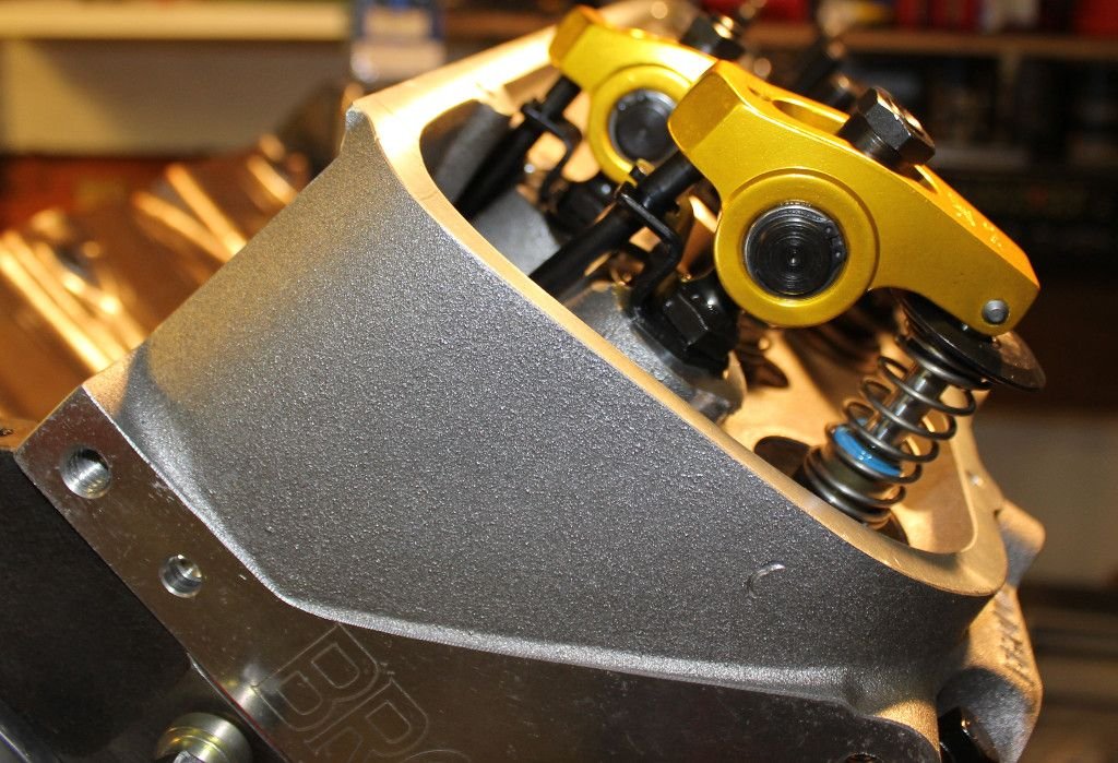

I was trying to measure push rod length on my 489 build. Measurements didn't make sense, they kept changing.
Then I noticed the dial indicator moving on its own! The checking springs are overpowering the springs in the Morel Street lifters!
The springs are from this kit:
http://www.summitracing.com/int/part...1056/overview/
Checking springs on the head:
Oh well, off with the checking springs again so I can shorten them a little.

They do look quite thick my checking springs looked thinner

Can you disassemble the lifters and put washers in place of the springs?

I'm not sure if the solid version of the lifters are same height as the hydraulics. They are Morel Street hydraulics.
Shimming the lifters would be possible, but then I would need one extra lifter pair (I wouldn't want to re-use the lifter after having taken it apart and put stuff inside).
Today I cut the checking springs, but it seems that they are either too hard at full lift or too weak at no lift depending on how much I cut off. I guess I should get a better set with weaker (thinner material) so that the difference in tension will be less as the spring is compressed.

DS, well it reads like you are trying to measure the p-rod at some lift other than mid-lift. You want to measure with the rocker arm 90 degrees to the stud when the cam lobe is mid-lift. This is very difficult for beginners as you really need a lifter/follower tool (or solid lifter as mentioned) to find mid-lift of the cam lobe and I think you need a solid lifter/follower tool for this. Yes it needs to be the same height as your lifters. For unique lifters you might need to buy an extra lifter and make it solid with some type of epoxy.
My self I never use checking springs because I use a cheap plastic p-rod checking tool for modest lift cams (0.5") and I can feel when the p-rod is at zero lash. I suggest using a solid p-rod and try to depress the lifter cup with it to get a feel for what it takes to operate the plunger inside your type of lifter. If you notice the vendors sell p-rods in 0.010" increments and mostly 0.20" increments so what I'm saying is close is good enough as long as you have a good pattern on the valve tip and the roller does not reach the edge (but yes the more centered the better).
