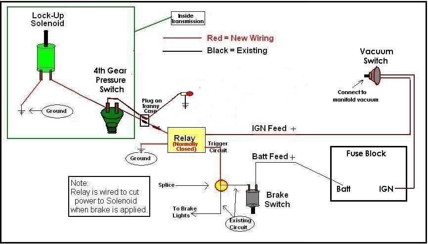

Here is a pic showing measurements you may find helpful:

do you have to connect the lock-up function at all?
i have read that it will drop the revs to much, extra 200ish, and because of the 3.08 rear, that it will hunt in n out alot under load.
or will that cause other problems if lock-up is not used?
3rd in the 200-4r is the same as "d"on the th400, 1:1
so if it was left in 3rd around town and only used the 4th/od on country drives or above a certain speed,
it should be fine shouldn't it?
so if i came to a hill or needed to pass in 4th/od, put my foot down/booted it, it would drop back a gear like normal....
or am i looking at this all wrong?
would have looked at the b&m speed activated controller if needed.
everyone talks about home made controllers using on/off switches, relays, timers, vacuum switches etc.
but i haven't found any actual printed circuit diagrams showing/comparing how it's done...

Originally Posted by riverracer au
do you have to connect the lock-up function at all? If you want to use the car on trips I would recommend you use the lock up and it is a different torque converter than std so make sure you get one that matches the transmission.
i have read that it will drop the revs to much, extra 200ish, and because of the 3.08 rear, that it will hunt in n out alot under load. It wont hunt in and out of lock up if set up correctly.
or will that cause other problems if lock-up is not used? You can overheat the trans if using 4th a lot without lockup.
so if it was left in 3rd around town and only used the 4th/od on country drives or above a certain speed, That is what I do.
so if i came to a hill or needed to pass in 4th/od, put my foot down/booted it, it would drop back a gear like normal.... Yes

B&M sells the manual lock up kit .I drive around town in 3rd ,only use 4th and the lock up on the hi-way .don't apply alot of power with the trans locked up .if you race ,put it in 3rd .I love the way the 700r4 works with my car .luckily my cousin builds racing transmissions ,so I get them for cost .
